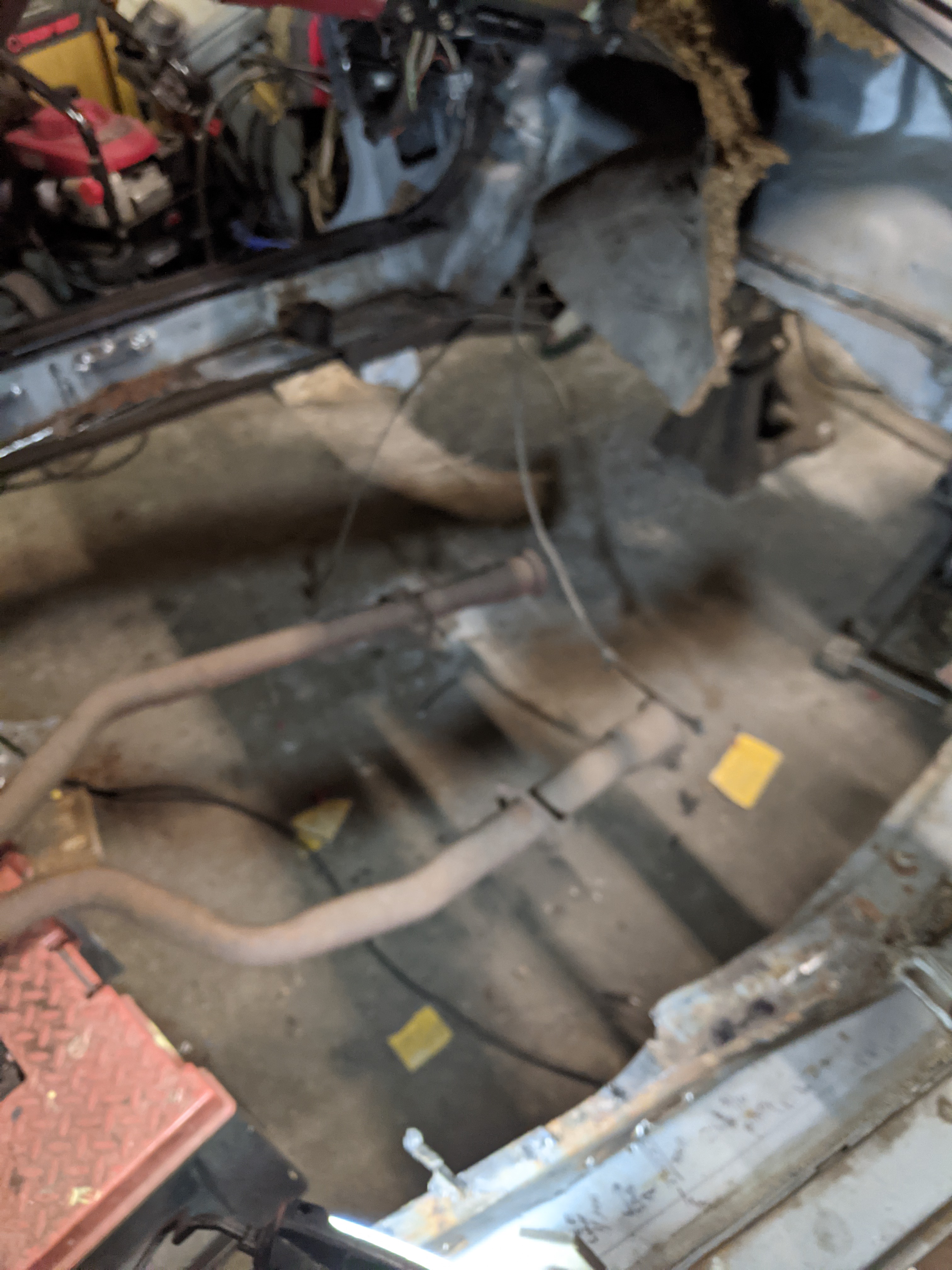

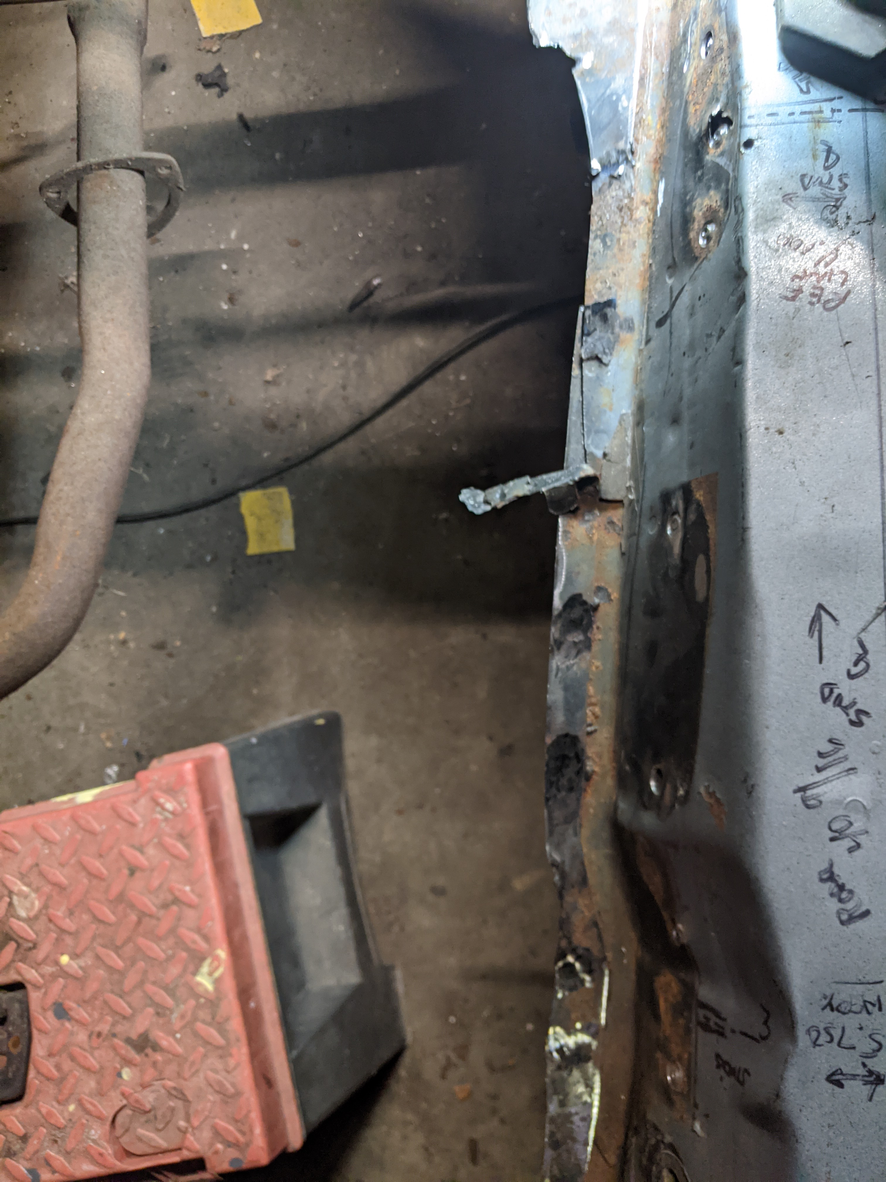

Well floor pan is out,,, waiting on the delivery and I will spend the weekend removing spot welds,, oh the fun View attachment 10923
Well the floor pans have been stamped out and are sitting in Taiwan waiting for a ride to the states, I was told it would be a few weeks when I ordered the pan,, if it is here by May I will be surprised. If I would of know that I wouldn`t have ordered it. No one has a one piece floor pan in stock,, so I wait,, time to put the quarter panels on my 83 Camino,, I have those already,, new post in a week or so.
