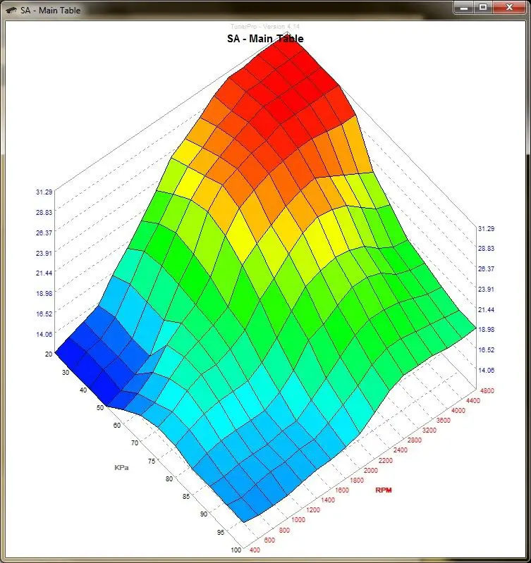

That makes me feel better, I was thinking it was oil. I've had a few hits of detonation trying to dial in my timing with the computer, could that cause something like this? Within the distributor's limits I can program it to basically any amount of advance I want, referencing the MAP reading and RPM.
That's not the current table, just an example of the flexibility. Low KPa is high vacuum, high KPa is low vacuum.

It may be a point to consider regarding the rpm that you are experiencing the miss. The surface chart you included begins a ramp up at 1800 rpm. What is the 3rd axis? I see rpm, pressure, and ??
The vertical axis is degrees advance. My table looks nothing like that now though. I suppose I could pull timing back and see if it makes a difference, but the fact is still that it was only on a plug or two. If the timing doesn't make a difference I may try a junkyard coil and see what that does. I don't think it makes a difference but the coil is mounted on the firewall sideways... it's a stock style one though, not oil filled.
