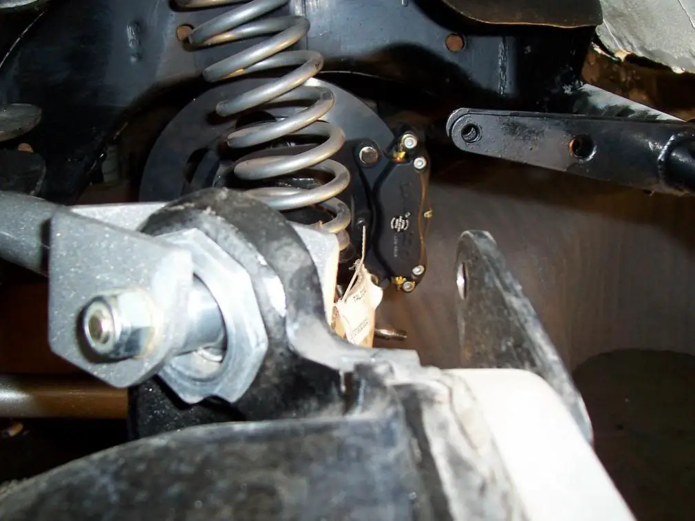

bad thing I see about speedways design is the area it can swivel before the bolt or spacers hit the bushing housing. I dunno how much that might really matter but it's sure not as great of an angle the trz style has.

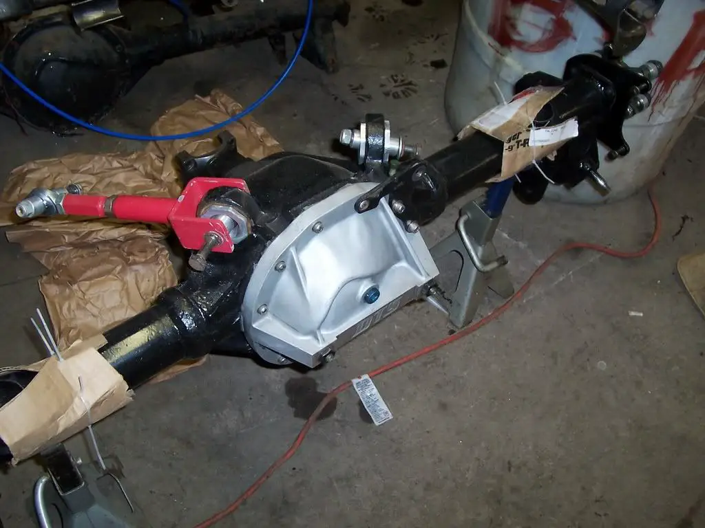

Not a TRZ piece but the same thing.. Had to trim down the hex part a tad because it hits the pig, other than that easy simple install. I'm pretty sure only the drivers side touched.
