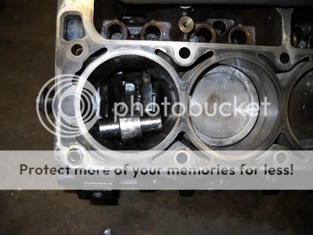

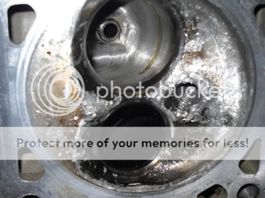

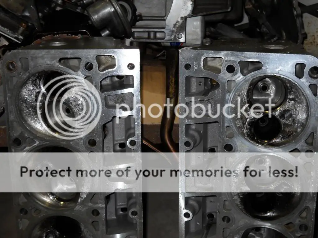

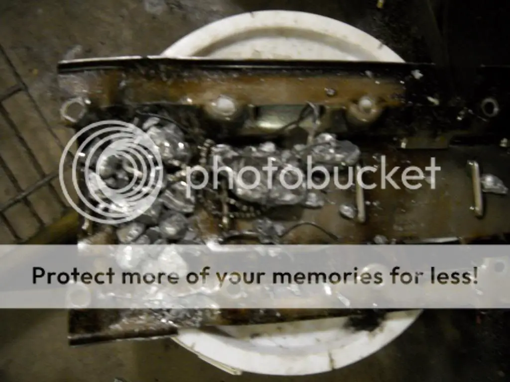

Well, made some junk real fast, first pass off the trailer shorty past the 1/8 mile she let go of the 1 and 2 pistons, the tune on the data logger showed it wasnt to far off and the timing was generous, what it did show was 25lbs of boost and the older stock pistons dont hold up well to that so a different boost controller is in order.

Cool! Sometimes I catch myself in a big darn rush because i wait all month for the 5 hours of racing, but try my hardest to answer any questions that people have and always try to help. It was a good time, made 6 passes, first pass was a 10.80et and the last two were 9.70et at 139mph. Theres some changes to make for the next rsd, on the 5.3l thats currently in the car has 6.0l heads on it witch make the compression way to low, on the last two passes i threw 25.5psi of boost at it with 16 degrees of timing. I figure it should have gone a lot faster so its getting the 5.3l heads back on it to build more compression, I'm really just getting started with this set up. Its cool meeting people on here from the area, do you go to all the rsd's? what part of wisconsin are you from? thanks for the comments, they help drive the next stage. John

Its real cool what your doing but the pictures of blown up LS parts don't convince me to build an LS very much!! :D
