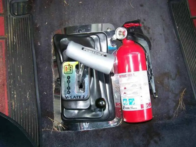

Think I'm going to attempt a rebuild on the Saginaw...
And here's some video of a v-gate...
