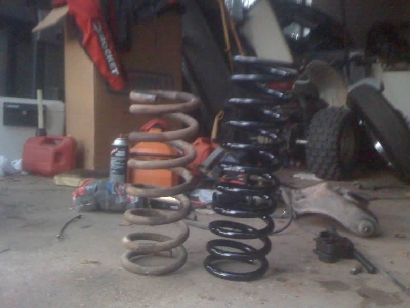

DFWMalibu said:
this is the difference between a v6 and a 47130 212lb trick spring..
Chris K.
i took one of the stock 6 cyl springs out of my car last night and put it next to the new trick spring i got. it's only about 1" taller than my stock springs and has 2 more coils in it. as mentioned, i have #47205, which IIRC, are for front end weights in the 1660-1720lbs range vs the ones shown here, which are for 1600-1660lbs. i hope this works out!! let me tell ya...it wasn't much fun getting the old one out, so i can imagine how fun getting the new one in will be!

FINALLY got them in!! wasn't all that bad. i'm SO glad i didn't get the lightest version of trick spring for my car. the front end dropped at least 1.5-2" as soon as i put the car down on the ground. i hope it doesn't settle too much more than that! guess i'm doing rear springs too now.

the car that I installed the springs in was already lowered so I don't have a good reference...
