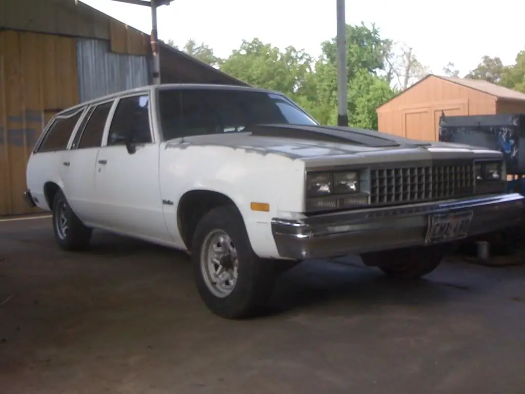

I have a 1983 malibu wagon and I had to remove the passenger side rear side window for a little rust repair. The trim was drooping pretty bad when i got the car. I noticed when I removed the window that there was excess glue and broken glass still in the track. Guess I know what caused the rust. Anyhow I'm trying to source new or good used window trim. If not I will have to make the junk I have work. Any ideas?
