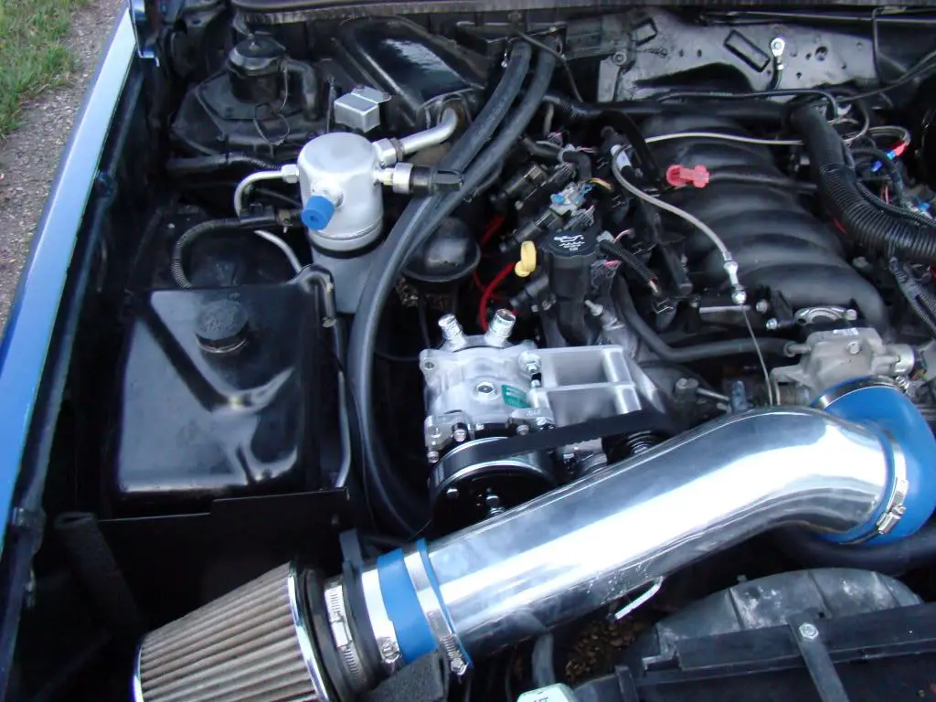

reinstalled some a/c, new accumulator, compressor, kwik performance brackets, re-wired a/c for low pressure switch, and wired in 2 relays one for compressor clutch and one to also trigger fan #2 when compressor cycles. Oh and installed the jeep cherokee shaft which is strange because now my steering wheel is off, hrmm, double and triple checked the shaft and it can't get put on clocked wrong maybe my old shaft was actually that bad? strange
