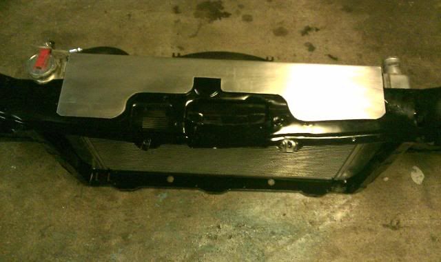

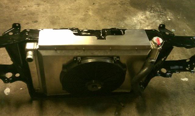

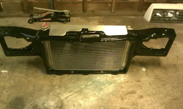

I welded all the holes in the core support and lowered the bottom of the radiator 1" so the 31"x19" radiator would sit flush with the top of the core support. Also made a radiator hold dowm from .080 aluminum sheet stock. I just cut it out with a jigsaw and bent it with a peice of angle iron c-clamped to the table and a block of wood.

Please post a picture(s) of the bottom of the support after you 'lowered' it. I have to modify mine the same way.

here are some pics. I have already mounted the core support since the pics so its knda hard to figure out what i did from the pics but i just cut the bottom of the support flush on both ends. bent 2 peices of 16ga about 3" in width to match the outside form of the support and welded it back together with a 1" gap.
you can kinda see in this pic, but i wanted the top of the radiator to sit below the top of the support so i didnt have to worry about the fill neck interferring with my cowl hood. I just radiused a half cirle for the filler neck to come in a bit further towards the front of the car. hope it helps and is not too confusing
let me know if you need any more help

Thanks bustedknuckle for taking the time to shoot those pix.........they do help.
Sometimes you have an idea of what needs to be done, but it helps to actually see it.
Thanks again.
