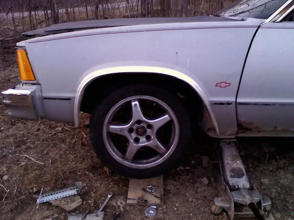

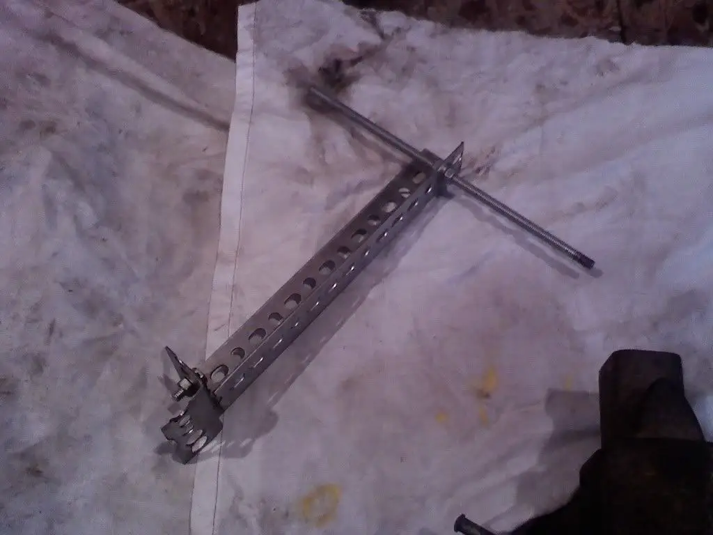

I'm going to be attempting a 275/40/17 on mine (came on the wheels :?), I hope I'm not being overly hopeful on them fitting :lol:
Overall width of the tire is about 10 7/8", height is about 25 3/4". I used my little tire tool doohickey and it looks like with the right backspacing (spacers) I can get it, but may rub slightly at full lock somewhere. Wish me luck! [-o< [-o< [-o<

Yeah, I haven't measured the back yet (no clue on side-to-side with the old bushings), just tried to get an idea of whether or not I'll even be close to being able to fit them. The wheels themselves are 9" or 9½" I think, maybe even 10"... they came in all those sizes :-k
Being a 40 series I doubt they'll flex much at all.

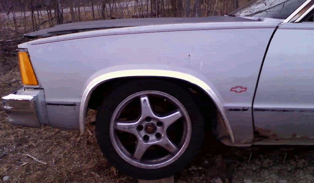

Okay, so here is the one I am working on. Finally got the drop spindles in. Think I'm going to drop the back 1" from here.
But, I said I'd post pics of the 235/60/15 front and 255/60/15 rear combo. Here's some pics.
Before the Front Drop (front didn't rub):
After the Front Drop (front does rub on hard turns and bad bumps/dips):
Current Stance:
My thoughts at this point is that I either have to stiffen the front to stop the rubbing or I should have went with a smaller tire than the 235/60/15. Keep in mind, I am using 15x8 corvette wheels with a 4" backspace.
No issues at all in the rear, plenty of room for something a little wider or taller. I didn't want too much sidewall for handling reasons, so I chose the 255/60/15.

Thats way too much front tire for that stance,Try somthing in the 225 or 235/50 or even 55 series sidewall if available in a 15" tire then you should be ok
I installed the monte ss sway bar that I had and it helped considerably. If I were racing, I'd just remove the inner fender wells and it would be okay, but it is a street car, so I'm not going to do that. I am going to replace the two top inner fender bolts with plastic retainers like late models use, and it should be okay. I don't think it is rubbing the two bolts now (with the new sway bar), but I want to be comfortable I'm not going to have a blowout going down the interstate if I hit a big dip in the road.
I realize the tires are larger than most would want, but I've always run 235/60/15 all the way around without issue (until I dropped the front). And I already had the tires bought. Next time round I'll go a little smaller on the front.
