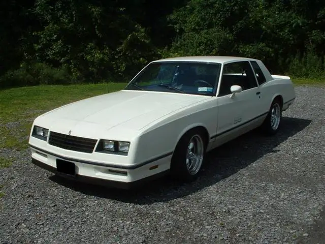

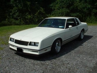

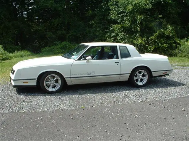

I have 17x8" TTII's with 4.5" backspacing, the 12" LS1 brake conversion and Lowered 3". No rubbing at all. The LS1 conversion only moves the wheels out the thickness of the rotor 1/8"-3/16" per side.
