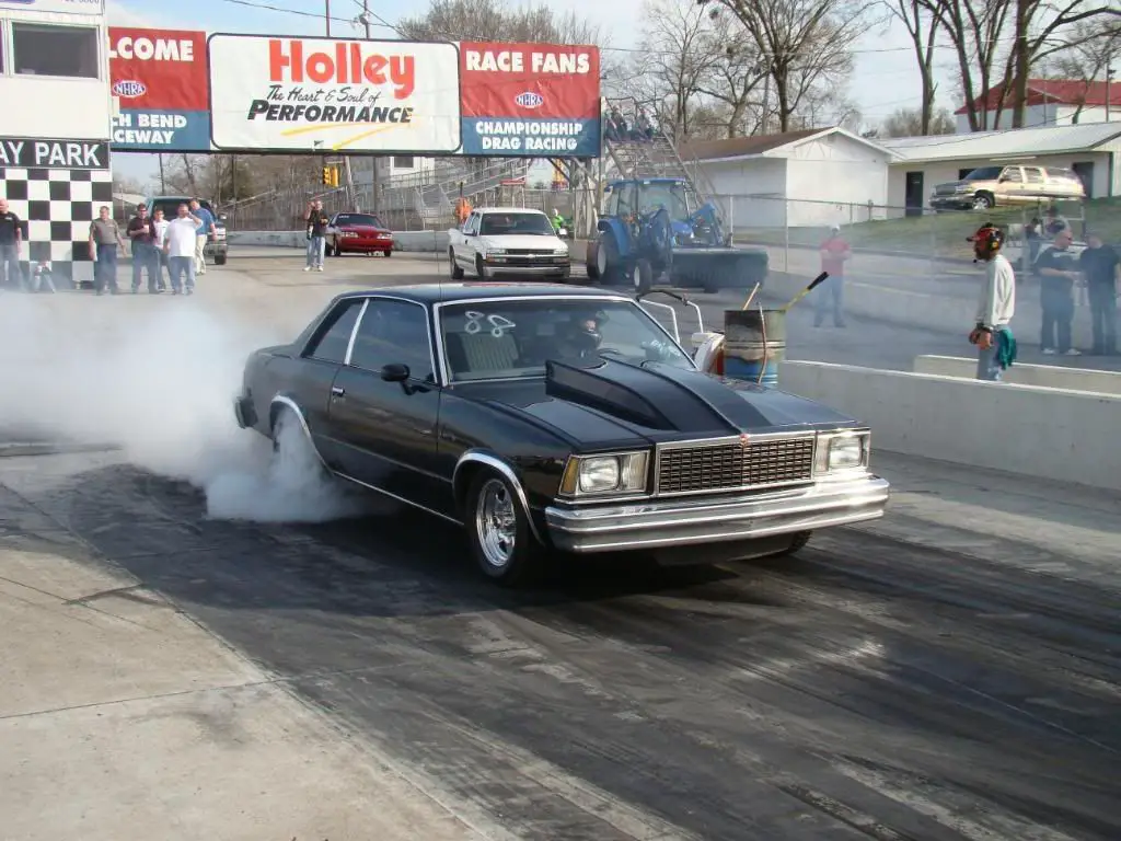

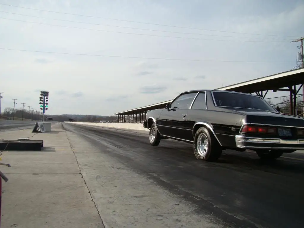

Hey Roller. Have you had a chance to run your car at the track at all? Just curious of times if you have..
Sorry for the picture post hijack. :oops: I will start my own thread sometime and post my pictures.

10.95@125 1.58 60'...hit the limiter twice, woops....Car should go some .70's...This on a 150 shot spraying off a push button a few feet off the line....car runs 11.70-80 on motor...Should run better, still have stocker upppers and pinion angle has not been set yet...Should have a vid soon at the track...Need to get it on a dyno and see what the motor likes timing wise...Not bad though for a pump gas, cam, intake and small shot street car to be in the 10's, I'm happy..
