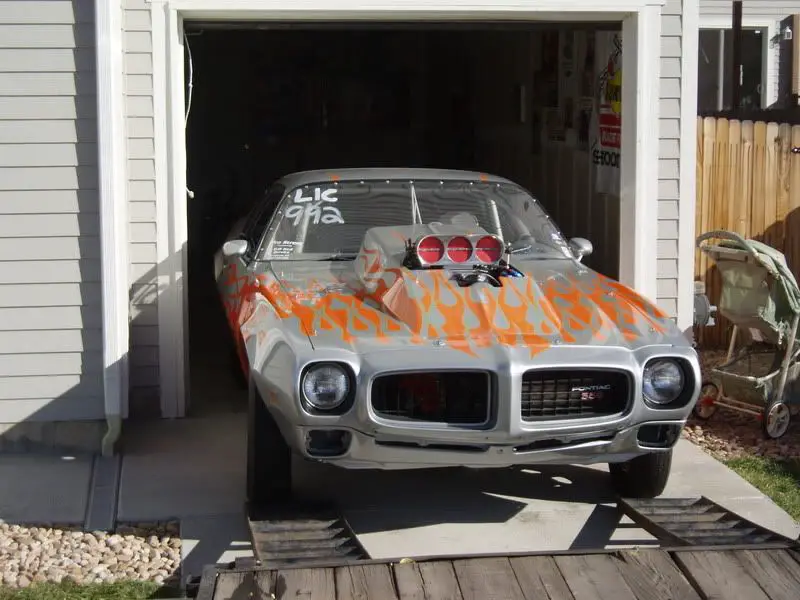

Car is a 25.5 backhalf car (not chassis, full frame, full steel body, cept the hood 70 firebird), and ran 8.08 this year @ bandimere (5800' above sea level).
This is about 2 years ago, I can't actually find any newer pictures... my friends have them all. :) I'll get some from this year's events from them and post em.
