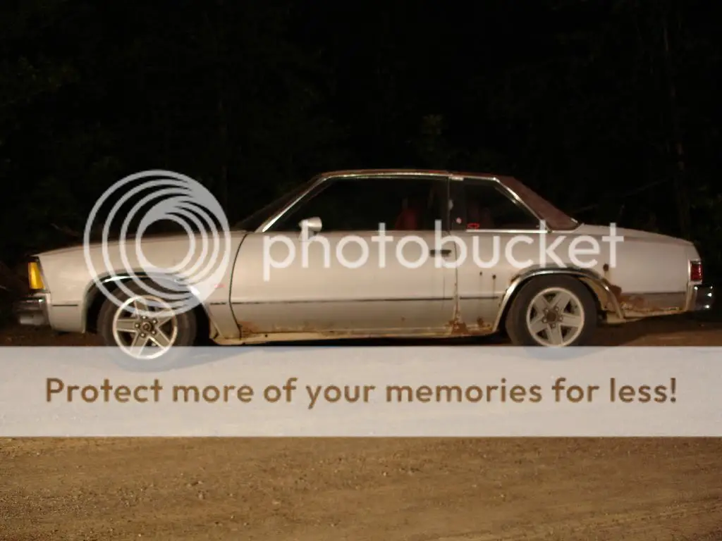

The car is outside almost where I took this picture, covered in snow Do you have a guess where it might be? I think the frame isn't more than 7" off the ground, if that.
