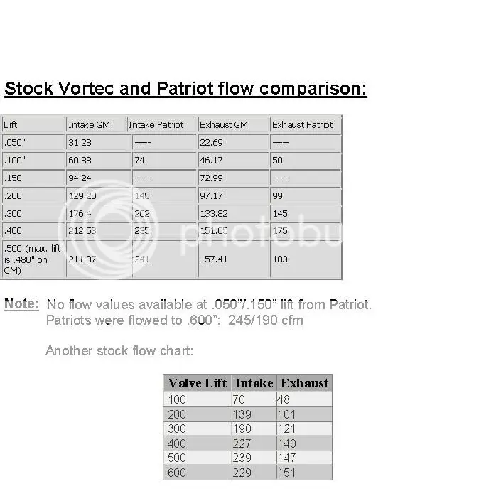

Unless you can get Vortec's CHEAP, the mods required to make them survive with bigger valve lift, a different intake, valve covers, etc. really add up, dollar-wise, to the point that considering aftermarket heads is a viable choice.
Here's a nice comparison Vortech to aftermarket:
http://www.2quicknovas.com/vortecheads.html
I've toyed with Vortec's for a LONG time but their purchase, upgrading to a stainless valve package, adequate valve springs and refreshing a set of used heads makes these a logical option.
The Patriot "vortec" 185's outflow Vortec's on EVERY level and still retain the Vortec's chamber and awesome port velocity you want on the street.
They come with all the goodies (stainless valves, plenty of lift clearance, great springs, retainers, etc.) in a lot heavier duty casting as well.
They're $695 delivered on Ebay every day.
See flow charts below comparing stock Vortec's to them.
Here is a link to Patriot's site for info on them:
https://www.patriot-performance.com/xcart/product.php?productid=206&cat=76&page=1

What grabbed my attention about the Patriot "Vortec" heads is their flow in comparison to Vortec's.
Telling me they'll shine just like Vortec's do around town and the added port volume will allow them to KEEP flowing where Vortec's fall off.
You're SO right.....so many heads out there only advertise max flow numbers.
Folks latch onto those figures and don't check out the low/mid flow of them.
See the flow charts I posted earlier in this thread for comparison.
VERY interesting indeed!
