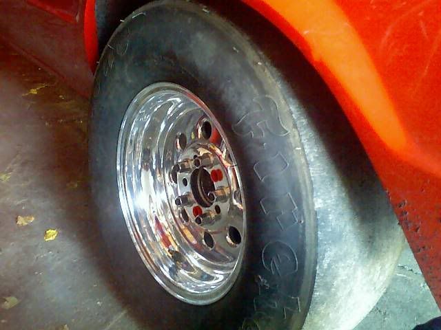

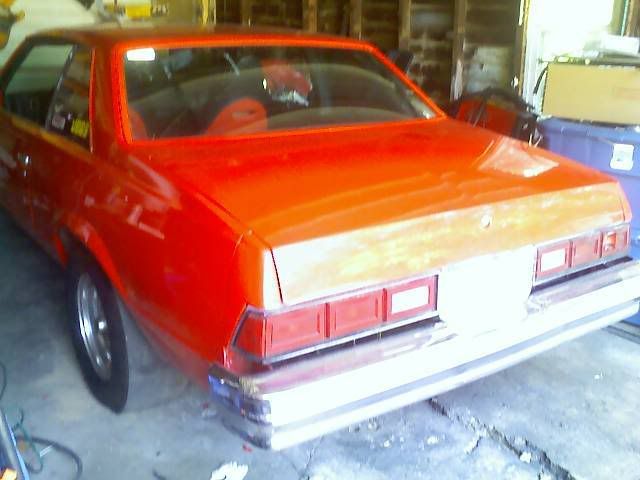

MEGABU
Aug 20, 2007
3,092
Blue Island, IL
a 15x8 with 4.5" backspace also works very well; tends to tuck the tire into the wheelwell a little more than tom's 3.5s, so it comes down to what look you like better. and like tom said, a 275 60 15 works beautifully! here's mine...
winditup57
Jun 6, 2006
848
Davenport, IA
Megabu, it seems as if your tires are bald...... :p
