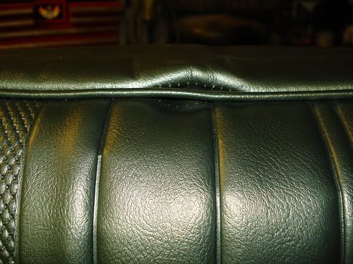

seat cover

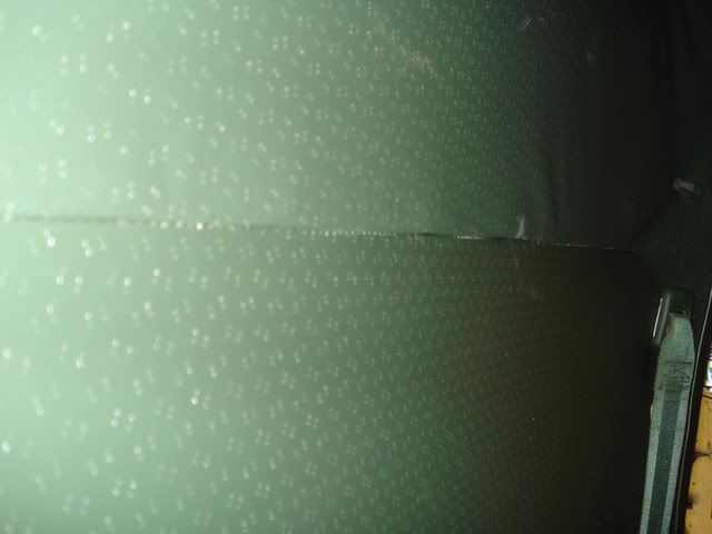

headliner
And I had more pics of the junk from them, but lost the on my old computer.
Frankly I don't know many local shops that can do heat pressed seams to duplicate the factory look, maybe you have such equipment, you'd be the first local shop I've seen with it, but I don't know you or your shop. The seat cover appears to be a dropped stitch by the sewing machine that caused that, had it happen myself many times in nearly 40 years. The headliner picture you posted looks suspiciously like an old worn out factory unit.

seat cover
headliner

The covers did have dropped stitches about every 10" all the way around, and the headliner was pulled from the box and installed by the car's owner.
