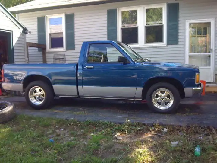

blown 78
Dec 10, 2007
1,011
South Portland, Maine
15x8 with 235/60/15 rear and 15x4 with 165s up front. I have a 275/60 on back now that looks killer i just dont have a picture. I know its not a GBody but you guys dont mind right :oops:
