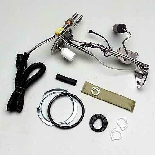

I'm trying to get my my new fuel sender in,but I need to redo it so I can hook up an electric fuel pump and run it through it. I'm hoping that when I get the fuel tank back together I can hook up my Holley Sniper EFI. Does anyone know what would be a good fuel tank vent add to the fuel sender. I am trying to modify my new fuel sender so I can use in tank electric fuel pump to pump it to the EFI system. If you have any ideas of a good fuel tank vent,that I could plumb into the new sender I would like your assistance. Thank you very much.

I have up on the new fuel sender and have ordered a EFI sending unit that I just bought from GBODYparts. When it gets here have to see how it will work.

Here's are pictures of the new fuel pump and new fuel sender.
Here's the picture of the fuel sender.
Does it look like I put it together properly?

Please be sure the rubber line you installed between the pump and the sender is submersible rubber line. The outside of regular fuel line dissolves when submerged in fuel and makes a mess inside the tank.

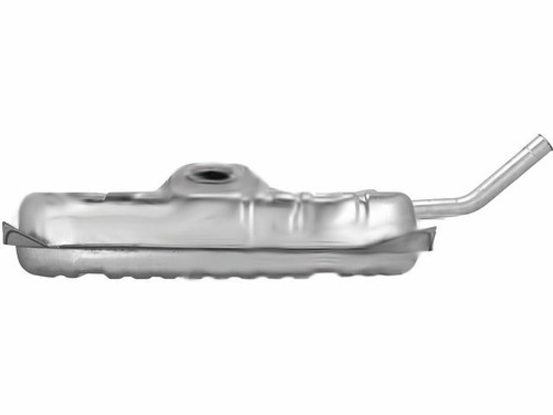

This tank has a rounded V shape in the back of the tank. The point of the v is a few inches from the fuel pump. The fuel pump is a Holley 19-369 pump. I spoke with Holley technical representative he told me the fuel filter that came with the pump would do the job well. I'll have to wait and see what happens.
