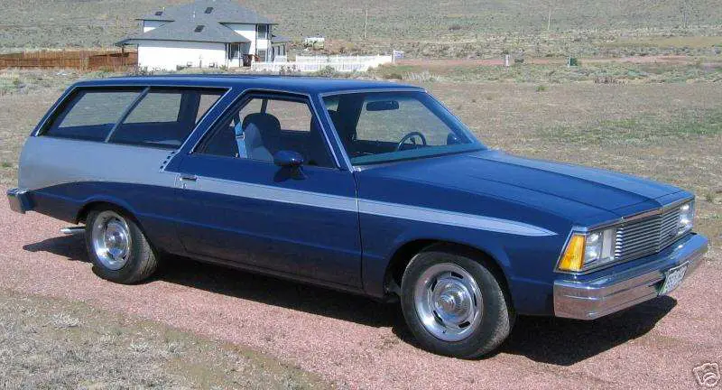

t5montecarlo said:
Angling the B pilar forward would make it look like a Nomad. :)
Seen it...didn't like it...made the roof look funky, IMO
matty man
Jun 1, 2003
1,353
25
Grove City , Ohio
Ribbedroof,, is that nomad look a like a Camino with a wagon roof fabbed on? I see what you mean by it looks funny or out of porportion,, the rear side windows are custom made,, Matty man
Ribbedroof
Sep 14, 2004
2,894
Rural Oklahoma
You know, I never really LOOKED at it before...the rear whellwell is HORRIBLE! I'd guess that they reduced it so the "trim" would not be too close. It isn't helping the looks of the car, though. Makes it look very rear-heavy, IMO.
There's a fella over on gbodyforum that owns a wagon the builder of the "nomad" also owned. He might have asked about the car pictured...I have no idea how they got where the car is, but I'd guess Camino door glass and perhaps modified Camino B pillars.
