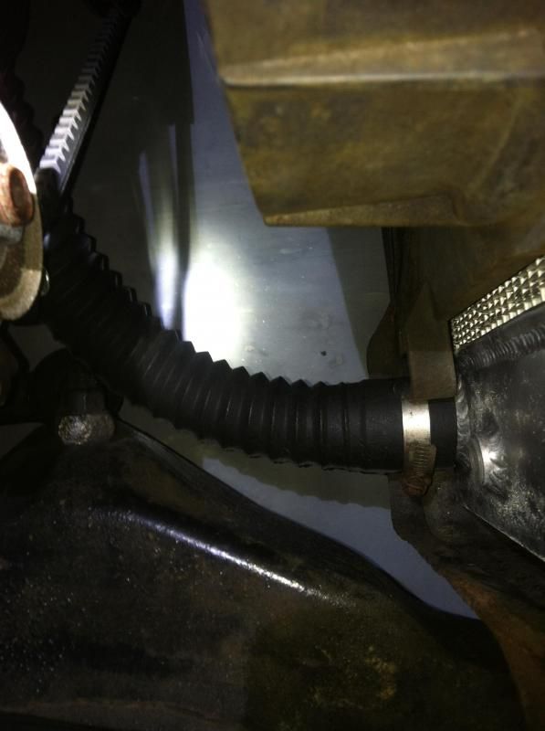

I had the same problem, ended up at CAP going hose by hose through their universal ones. After 20 min or so I found one that worked!

I'll do some searching and see what I can come up with, it was definitely an odd looking hose, but it works.
MISFITmalibu63
Feb 21, 2004
7,163
The Sticks... Tewksbury MA
finally got around to getting some pics... no PN on it, but this is what it looks like

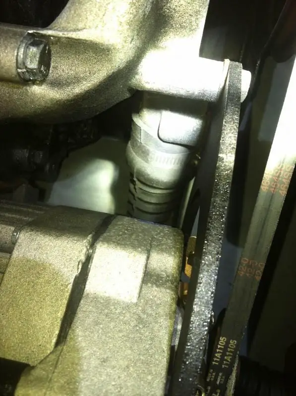

Found a gates hose that fits the 1.75" lower outlet on the aluminum radiators. Gates 22542 fits like a glove. 1/2 hour going through hoses at Oreillys, but well worth it.
This is with a jegs universal 31 x 19 radiator with an electric fan and a Mezzier electric water pump, but it should work with a standard water pump. Hope this helps someone out.
