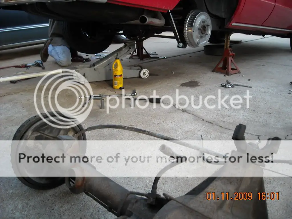

here's another shot of the old crusty 2.41 housing in the foreground and the 3.42 installed with Dad torquing down the driver rear wheel:
