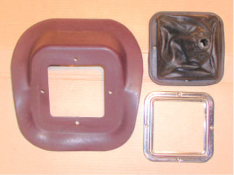

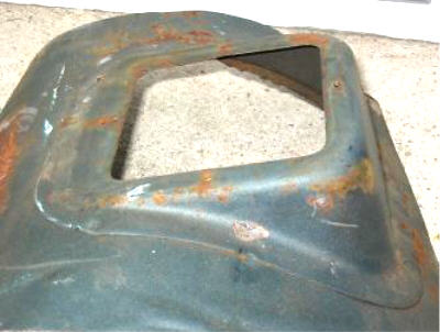

i know this post is long dead but hoping someone reads this, has anyone tried the metal floor hump from the parts place? i ordered the plastic one and it does not even come close to the contour of the floor. i am putting it in a 79 malibu if it helps
Correct; it is not supposed to fit the floor contours. It is a decorative piece.
The screw holes in the plastic piece are large. The screws are meant to pass through the holes, not thread into them, so you would not have had much success attaching a boot.
The price on the reproduction metal hump is very good. I used to sell used Malibu humps for that much money when they were plentiful and reproductions did not exist.
