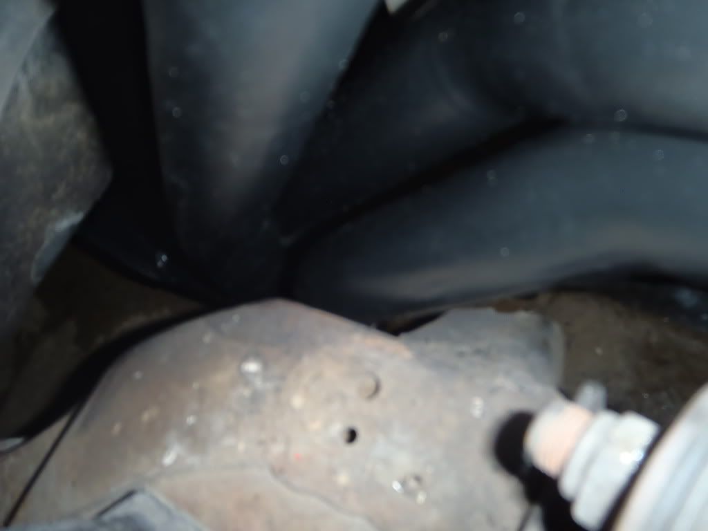

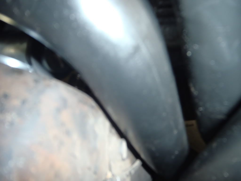

I dont have pacesetters but on my f-body long tubes I had to put a flat spot a few inches long on one primary right before it goes into the collector. It will hit on the curve in the frame as it turns out to the outside of the body just below the firewall.ranloachi said:Does anyone have any pics of what needs to be done to the Pacesetter f-body headers for clearance?
