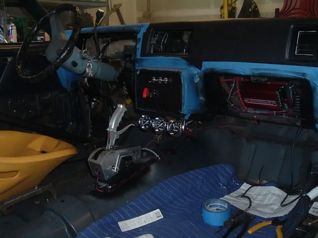

I just installed my volt meter. I put a switch in between the positive wire. 12 volts with car turned off. 14.2 with car running. I have a one wire alternator which does not begin charging until around 1200 rpms. It continues charging until the alternator stops turning.
