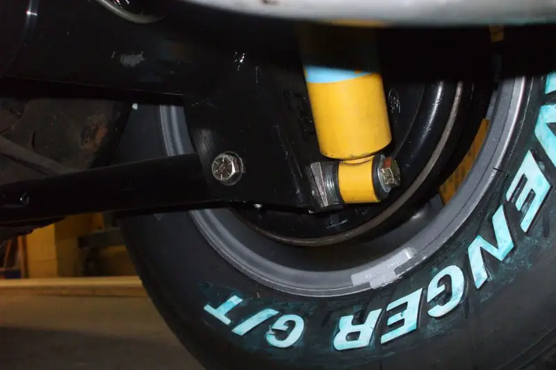

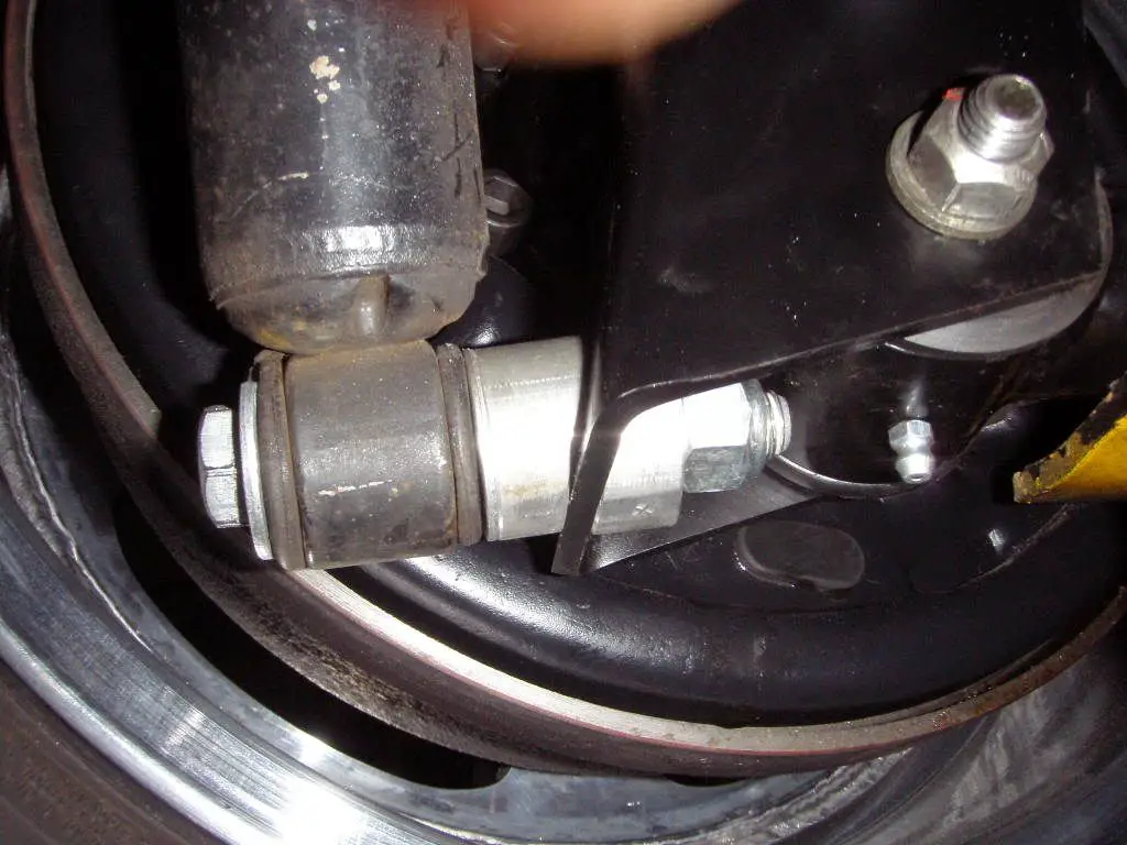

I apologize for never getting around to updating the thread with pictures of the spacers installed.......
........the angle isn't perfect, but a heckuva lot better than it was. An inexpensive solution to THEIR problem.

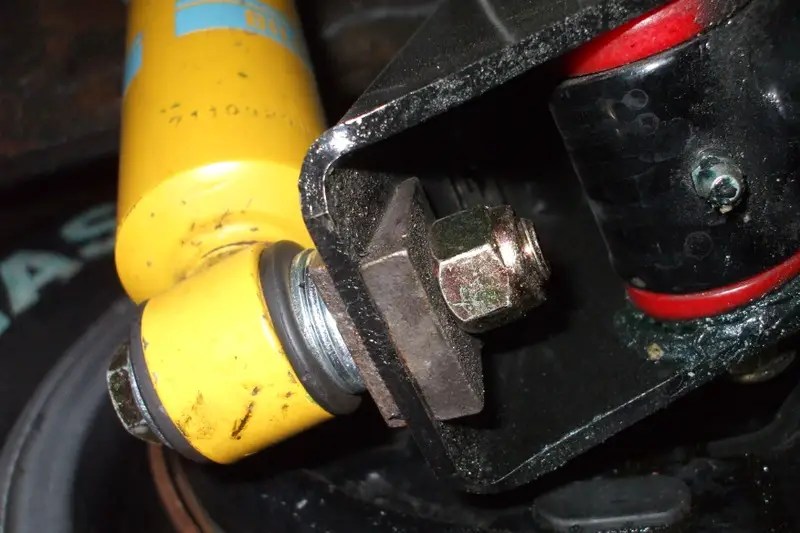

shvrolay
Nope.........tried it, another wedge is too much. What Slimbo did is perfect, but this works for now.
