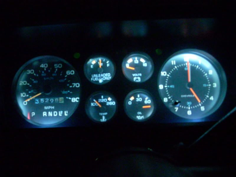

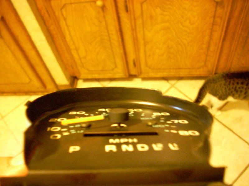

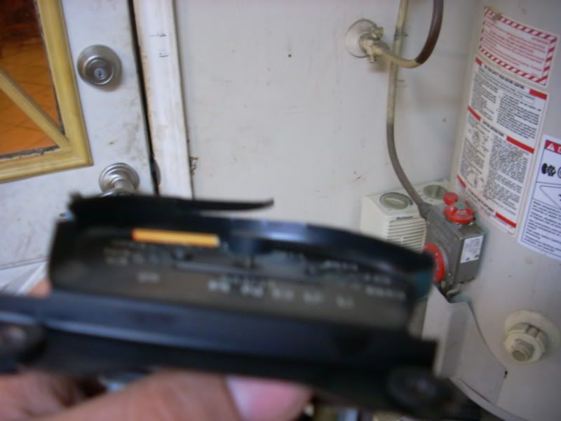

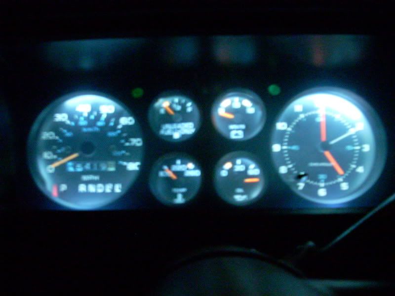

Alright guys got the lighting thing licked! Just for reference the "eyebrows" have no effect on the lighting as far as I can tell I trimmed them off and could not tell the difference, BUT what did make a big difference was trimming the speedo its self.
before
speedo before trimming
what I trimmed I removed this piece but left it in this pic for reference
Final product
Looks great, I did the same thing on my elcamino when I had it. Trimmed speedo, painted everything. Love it!!

thanks it made it 110% better at night

Wow! That made a huge difference. I still like the led bulbs though.
I'm assuming you lost the foam stuff for the light filters for the turn signal arrows (or didn't put it back in?)? You might try to get some thin black felt, some double sided tape, cut holes to let light through where it needs to be, and put it back together 8) I'm not 100% sure it'll work, but it's an idea... that is if you don't have the original ones. I hate it when light bleeds through like that.
SLICK78
Aug 1, 2009
1,120
La Porte, Tx
thanks for the idea but I have no idea why it looks that way in the pics because it does not look like that in person you can not see the turn signals unless they are on :-k and yes the leds are diff the way to go I will never mess with reg bulbs again
