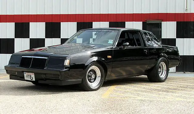

This GN belongs to non other than Lawrence Conley owner of CPP, Master Engineer. Retired and enjoying life.
This car I spent a gracious amount of time on in my younger years. This car had Southside LCAs and stiffened uppers done in house, adjustable pinion snubber,air bag, frame rail mod to accept 15x10s best 60' back then was 1.43 and low 10 second runs "BLACK" was retired from drag racing.
