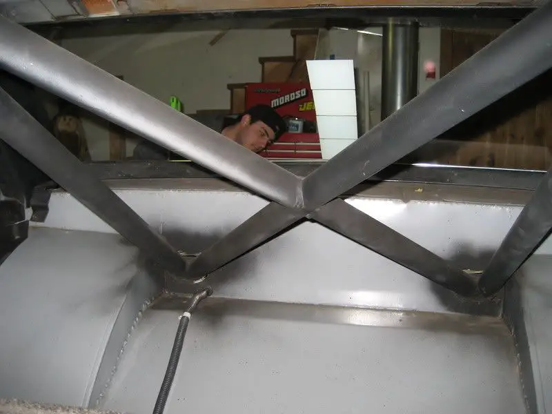

were about to start my 8 point cage , were do you suggest running the rear bars to? pics would be a great help if anybody has any

sorry they aren't good pics, i will snag more of the just the cage later...thos just happened to have it in them.
