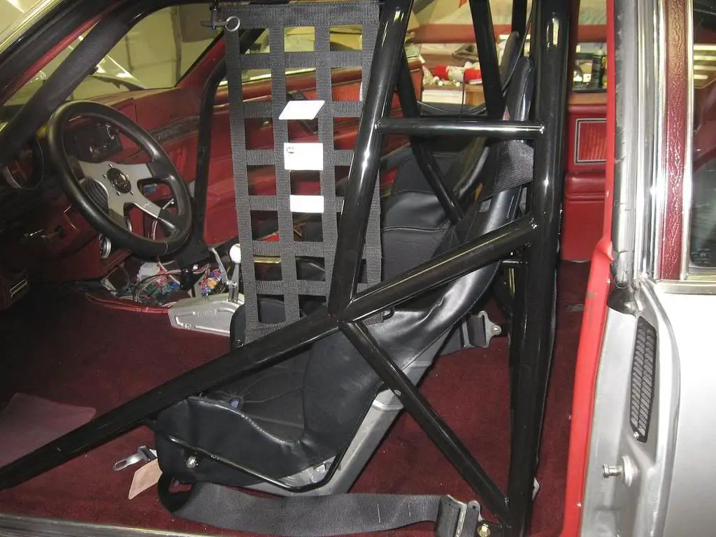

just got my elco out of the paint shop, so it's not put back together just yet...but here are some pics of the rollcage.

ok, I have a 8 point cage and want to know where the rear down tubes need to be placed to properly tie in the frame/suspention? The car doesn't warrant a cage but one day it will and want it to be right. Safety now, Requirement later!
Do I bring them in through the speaker holes, cut through the trunk floor and run them staight down to the spring perch mounts? Saw the pics of Supe's car is that the right way cuz that's what I had in mind.

JMO ..... If its a reg frame ( not full notch ) Running it to the top of spring perch is what i see most do . You can always add a bar off each side that ties further back to the frame if you want .
If you have a notch you can add it there or tie it to a bar that runs from frame rail to frame rail .
