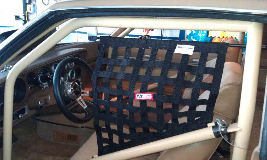

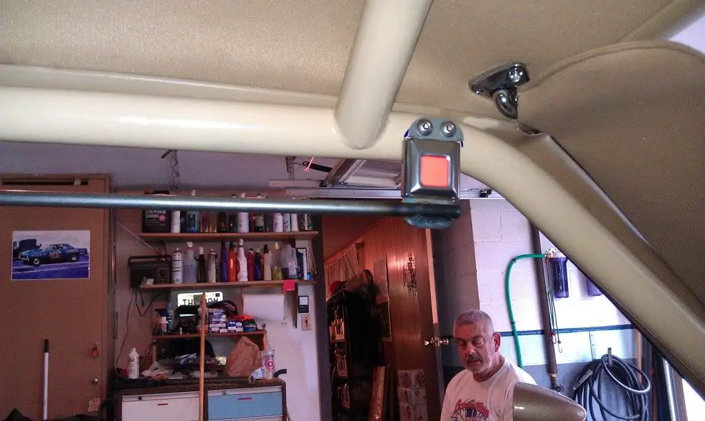

Making some progress on my cage. Lots of work to make it fit like I want, but so far pretty happy with it. Thanks to everyone on here, I think I have looked at the cage pics in this section a 1000 times

Nah thats all custom bent... heres some updated pics.
