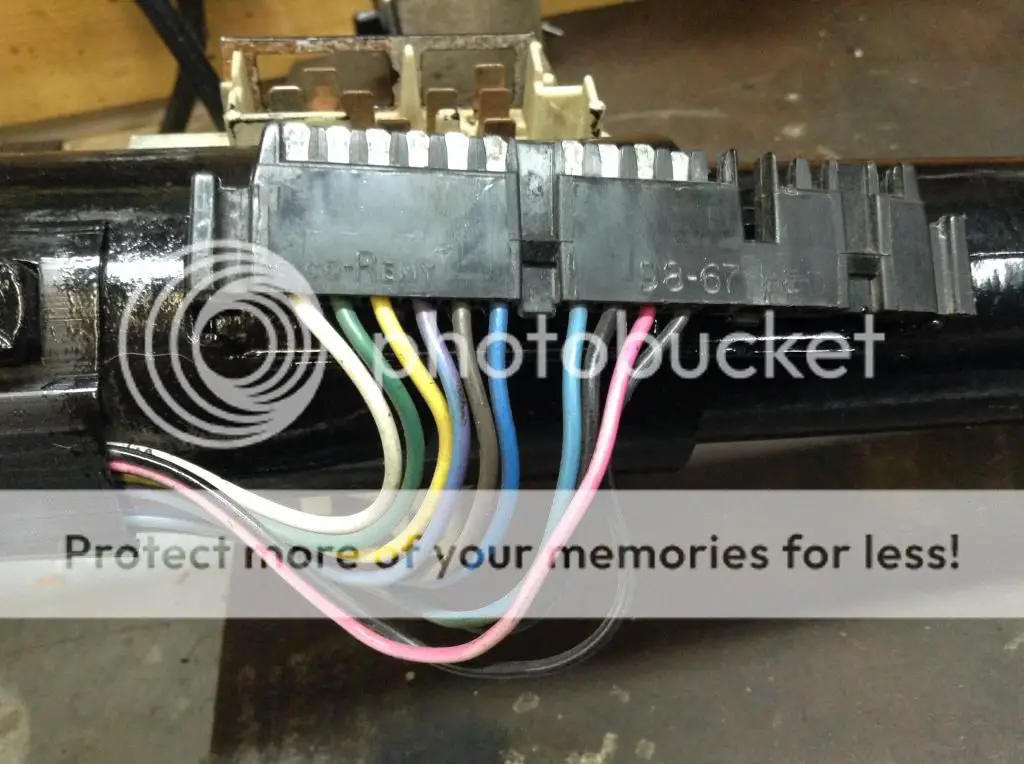

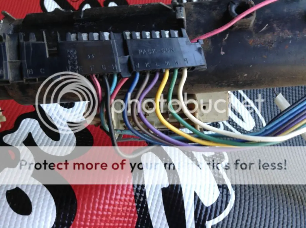

Here are pictures of the 2 columns that Roy has.
The first one is his current automatic column. The second one is of the manual transmission column. The only difference I see is the pink wire has a black stripe in one of harnesses and has no stripe in the other. I don't think there will be any problem.
