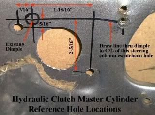

Bu- here's a template for locating the F-body/McLeod 139001 clutch master cylinder to be used with John Bzdel's pedal:
Here's a direct link so youo can save or print it:
http://www.shiftn6.com/images/cruiseholedims.jpg

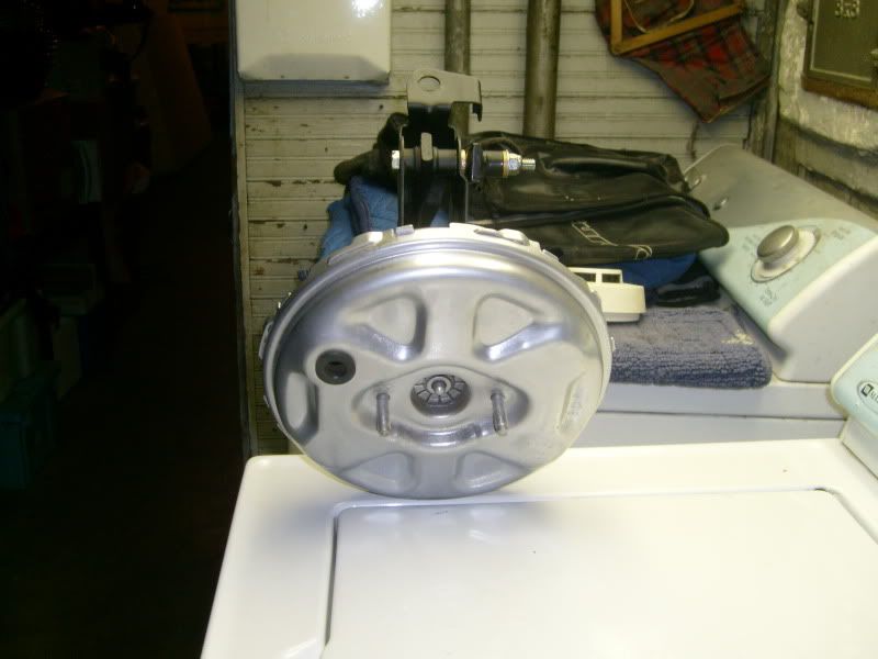

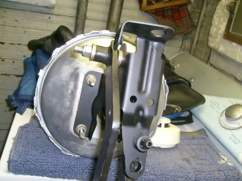

lol here is lil more of an update to the pedal assembly and booster wire brush, sand paper, degreaser and some spray paint made it look really nice
there was a loose washer and thick foam washer that look to have fallen out of the booster i just put them back inside the booster tube is this normal or do i need a new booster?

Looks good man. The mcleod master will work just fine with the stock slave. Just make sure you double check the throw and adjust your pedal stop accordingly. The bigger mcleod master will be able to extend that slave cylinder a bit further now.
