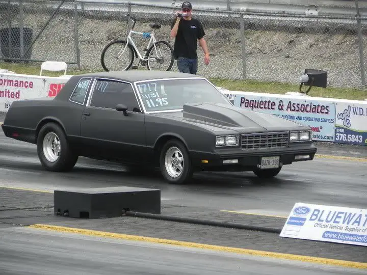

my car with stock V6 front springs and variable rate coils in the rear

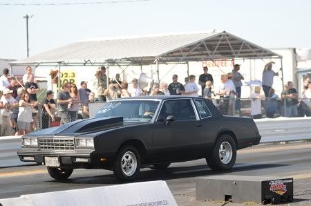

my car with trick springs all the way around
