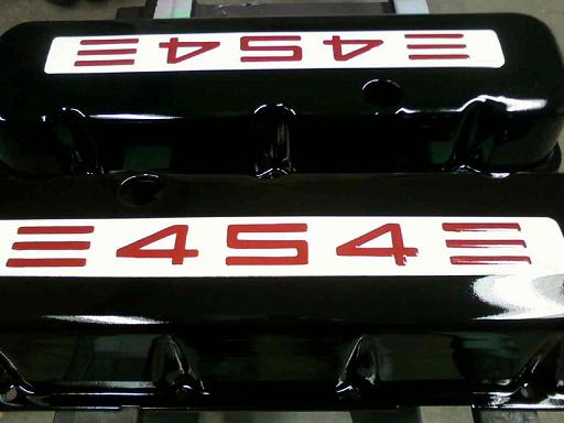

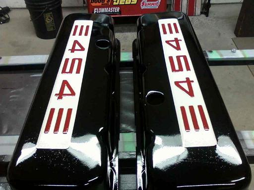

Went ahead and painted up some new valve covers to match the Malibu's paint job. What ya think?

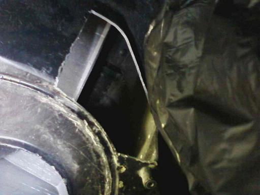

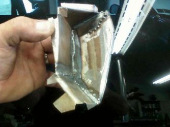

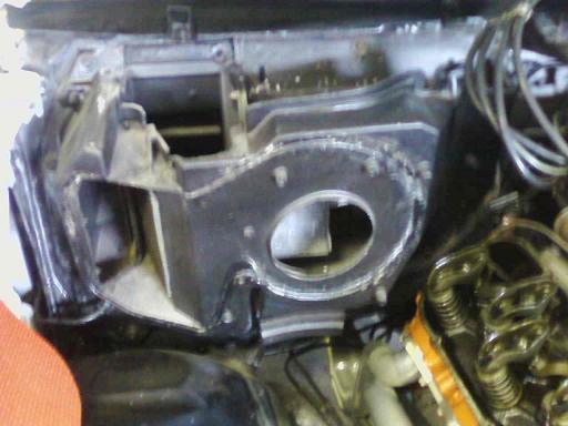

Cut up the heater box and made up a fab piece to go in . That way still could keep the heat fully functionabl and run tall valve cover to cover the new rockers (not yet put on) These are very easy to put in and the cutting of the fiberglass box was easy as well with my dremel max. Worked out great, thinking about making some of these to see if anyone else might be interested in keeping heat and defrost.
