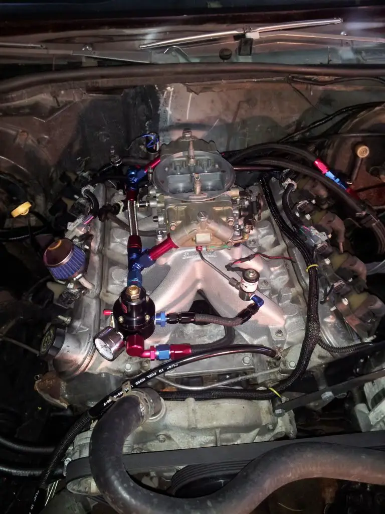

Thought you were asking about 454mali's... I was gonna say that's where I routed mine. I bent hardline almost all the way up to the carb... left just enough for the filter and enough rubber hose to connect to the carb... bent the rest of the fuel and brake system (besides the lines coming off the master cylinder) too. I'd strongly recommend prebent brake lines unless you're well experienced with flaring lines and have a good flare tool (had several leaks).
