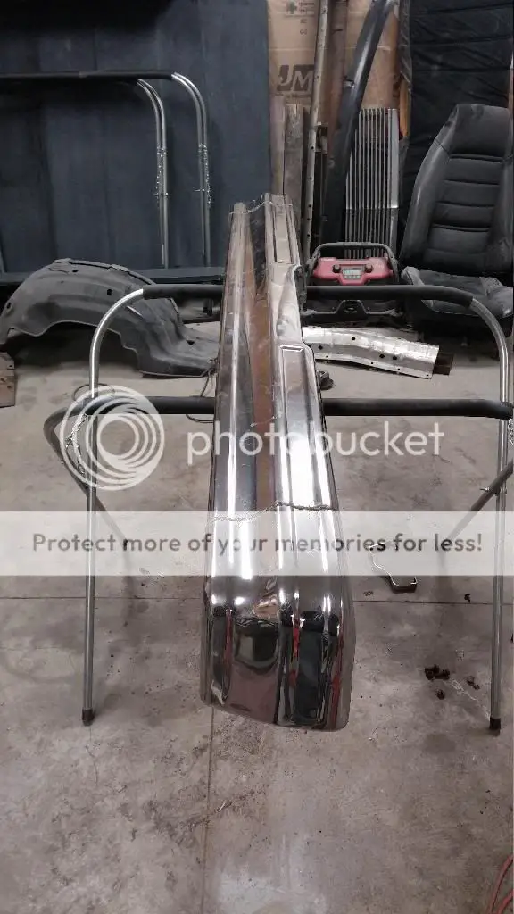

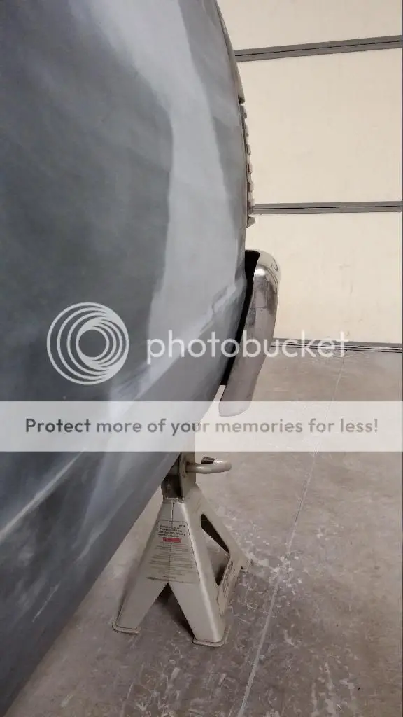

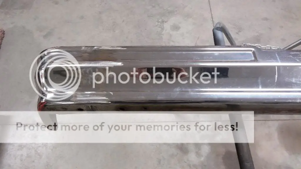

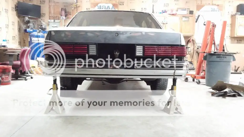

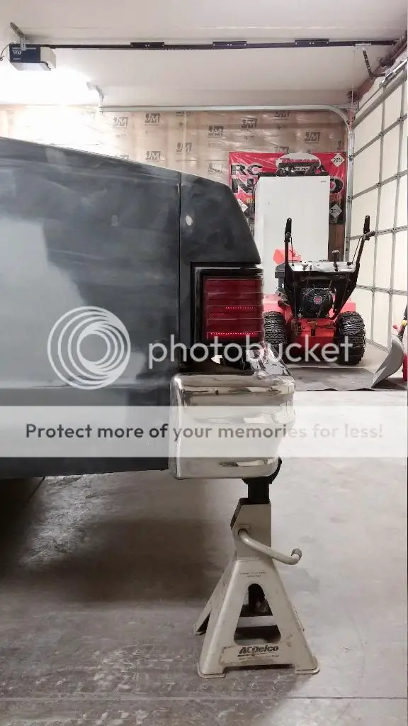

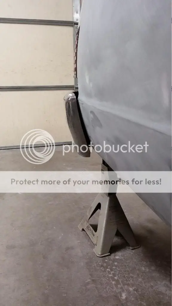

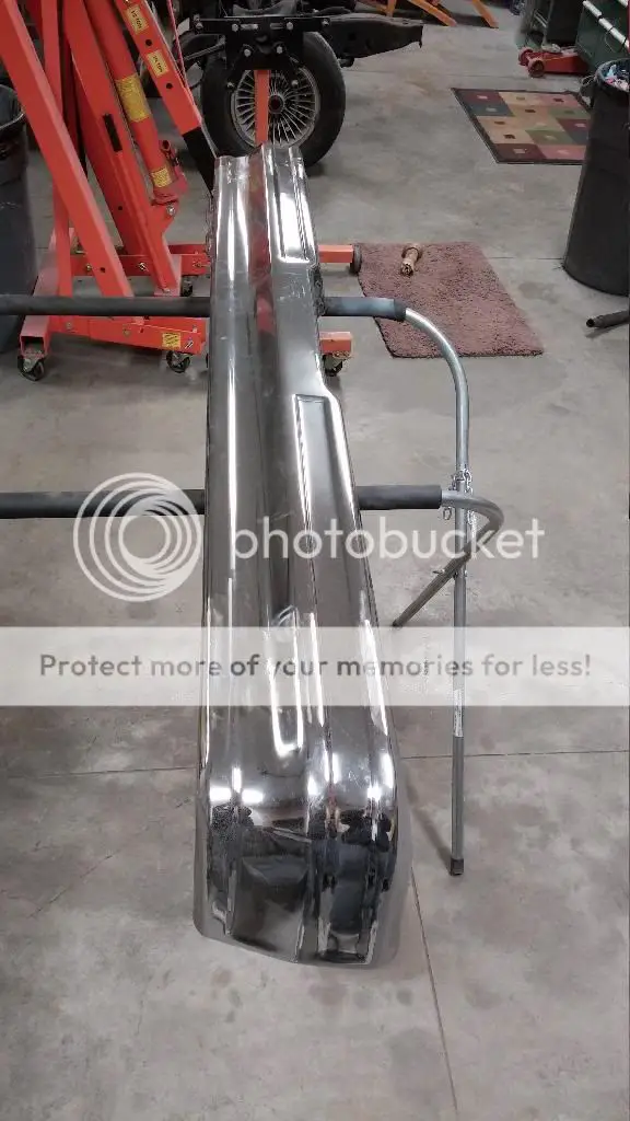

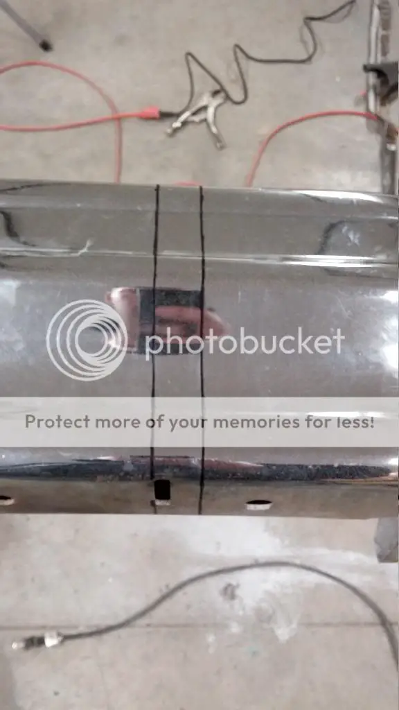

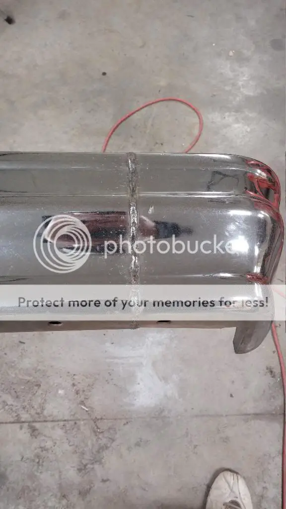

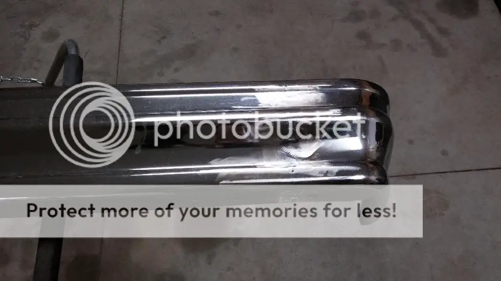

Got started on narrowing the bumpers. Got the rear cut, welded and ground down. Still need to DA the entire bumper, and apply filler to the bumper. Then should be ready for paint! Plan is to paint them body color.
I decided to narrow them 1 inch per side.
Hope to get to the front bumper tomorrow.
