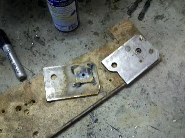

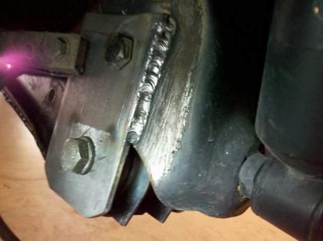

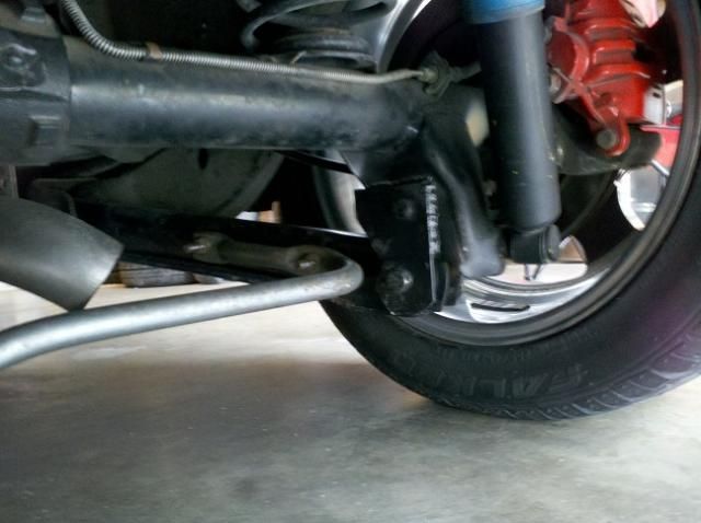

Here are some pics of the home made relocation brackets I made.
Honestly, if it doesn't wheel hop when I slip the clutch out at a certain speed, I can feel the car lift better than it had before. That being said, I guess I didn't really waste my time today.
Oooohhhhhh.....welds. 8)
Unfortunately I had to cut the inside bracket up with it welded to the car. I didn't make a relief notch for the sway bar to fit into place. :roll:
