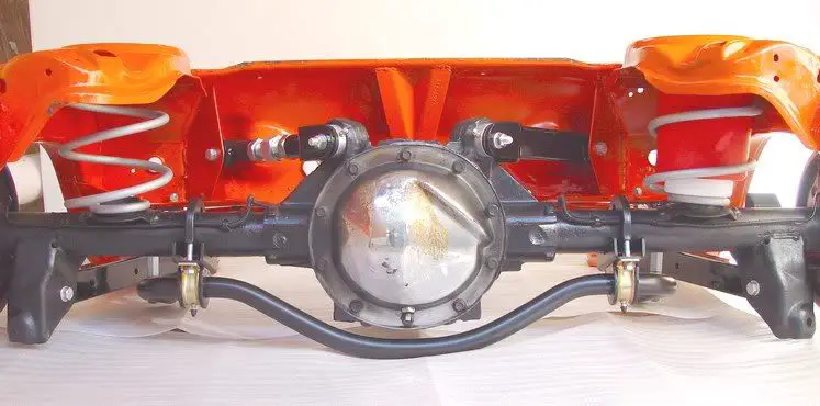

Hi, I;am about to install anti roll bar in my , i need to know where to put the tab on the rear? Do you put them on the back of the rear, on top in , :D the front. A little in site would help a lot.

Its really whatever works best for you...
I have mine on the back side of the rear....

Placement of the tabs on the housing isn't critical. You can put them wherever they need to be. You just wanna make sure they land directly under the arms. A good way to figure out if they should be on the front, top, or back of the housing is to just put them wherever they make the vertical link bars vertical. You don't really want the vertical links leaning to the front or back, try to get them perfectly vertical. Wherever they end up vertical is where you should put your tabs on the housing.

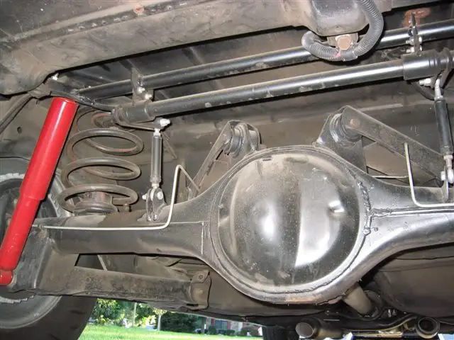

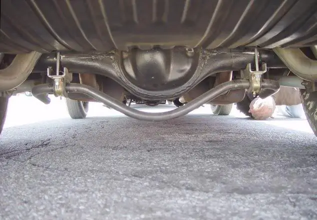

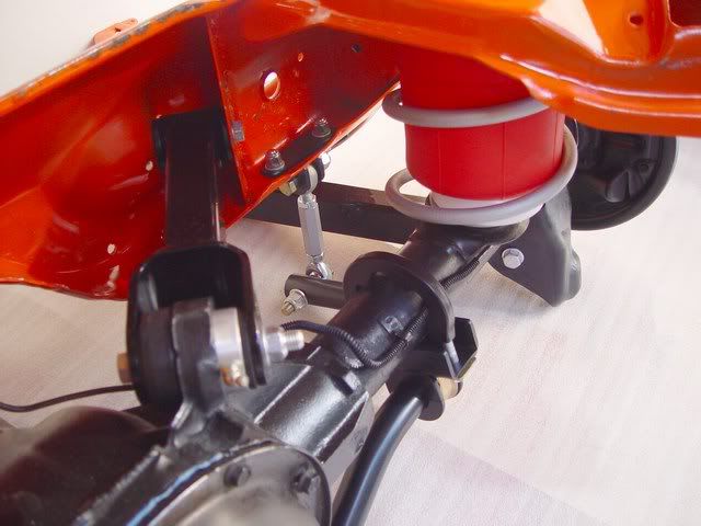

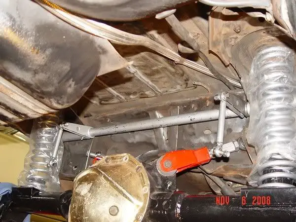

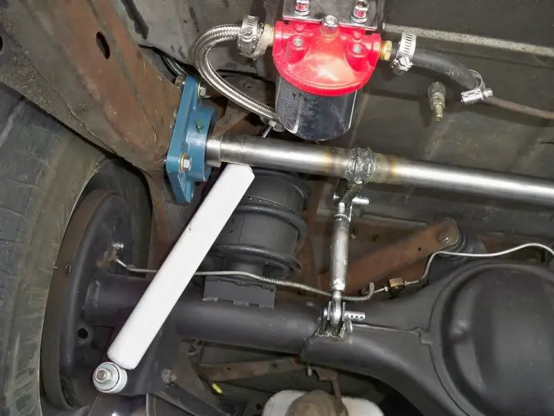

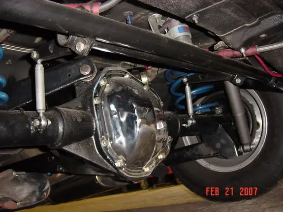

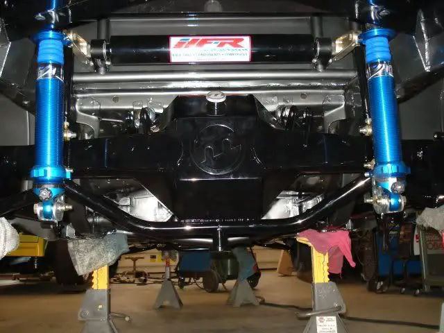

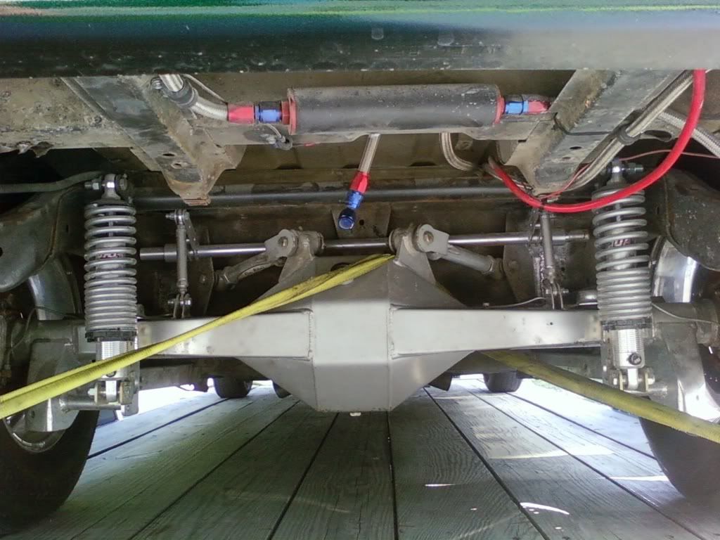

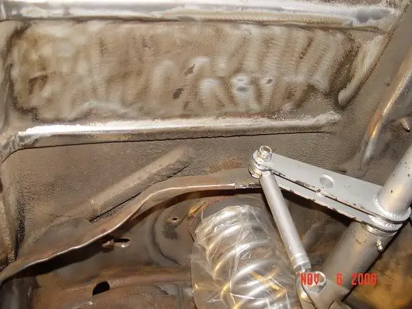

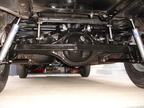

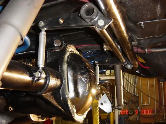

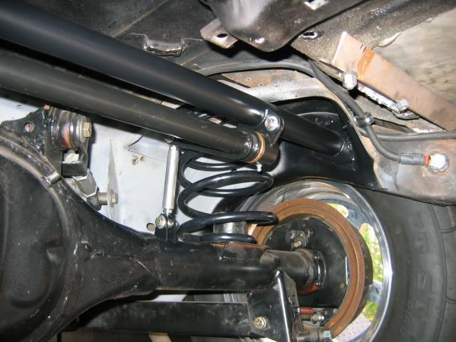

Post by Justahbu » Wed Feb 24, 2010 10:15 pm

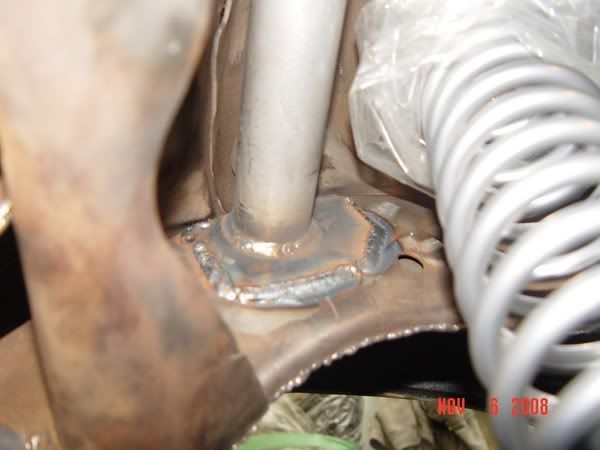

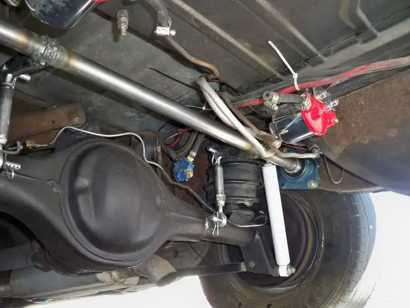

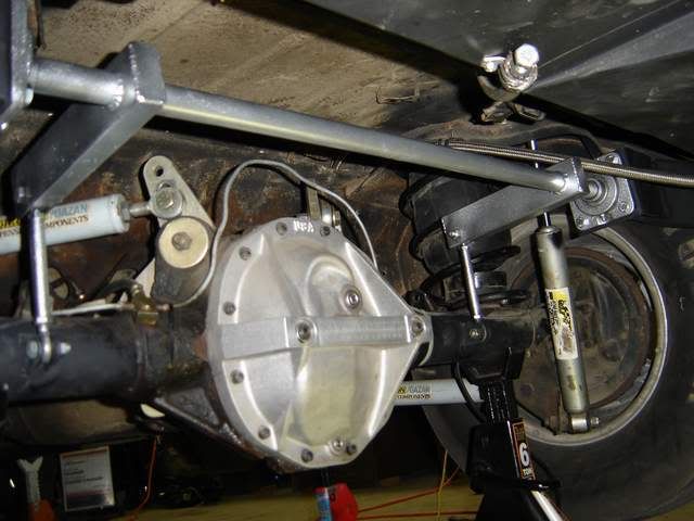

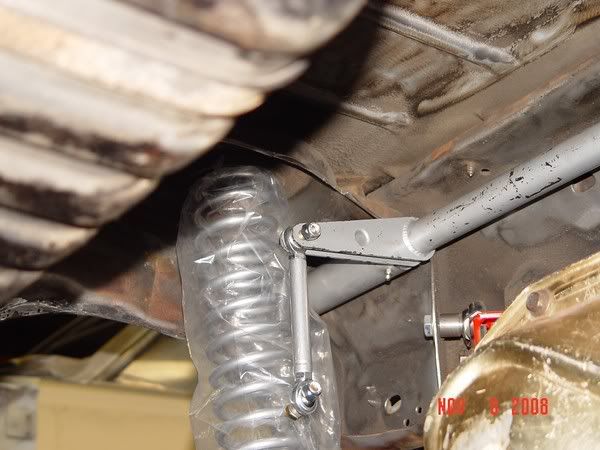

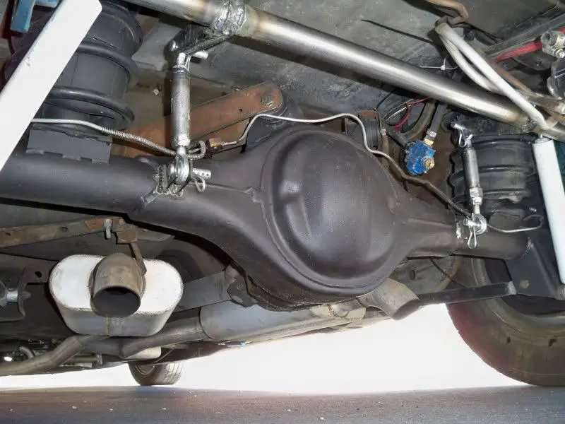

heres a bunch of pics I've collected

Thank you guy's for the pic.& info. That help's a lot . I hope to post sum pic. of my car soon. Once again thanks.

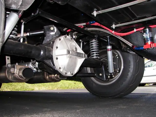

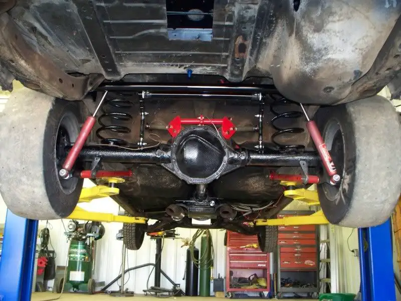

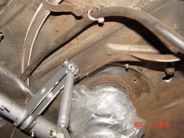

Post by elcoholic » Thu Apr 08, 2010 11:46 pm
kinda dirty under there when this pic was taken...but here is mine.

Post by PONTIACMAN3 » Thu Nov 18, 2010 5:13 pm
interesting, is mounting coil over springs a common thing in the stock perches and then puttin an adjustable shock in the stock location????

Anyone have any pictures of a anti roll bar with tail pipes routed over the axle?

PONTIACMAN3 wrote:interesting, is mounting coil over springs a common thing in the stock perches and then puttin an adjustable shock in the stock location????
Some class rules require stock suspension mounting points. Lee
