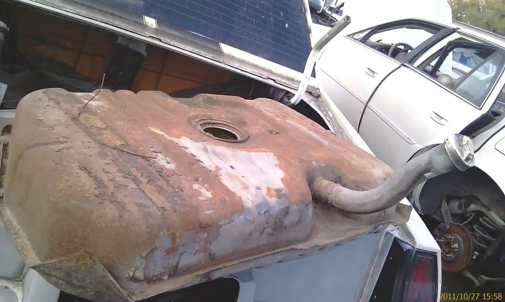

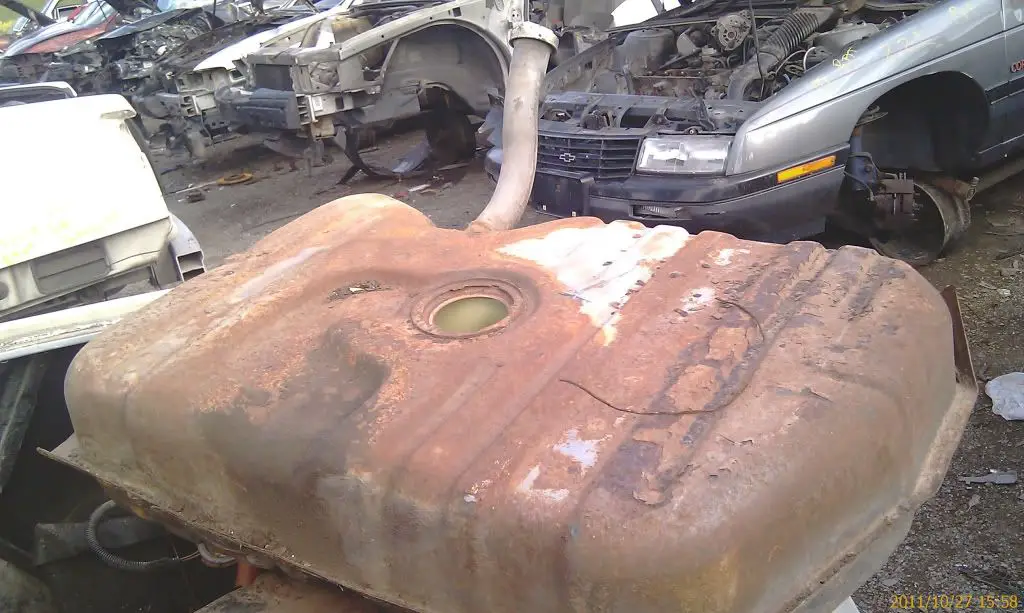

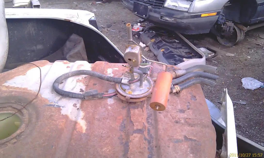

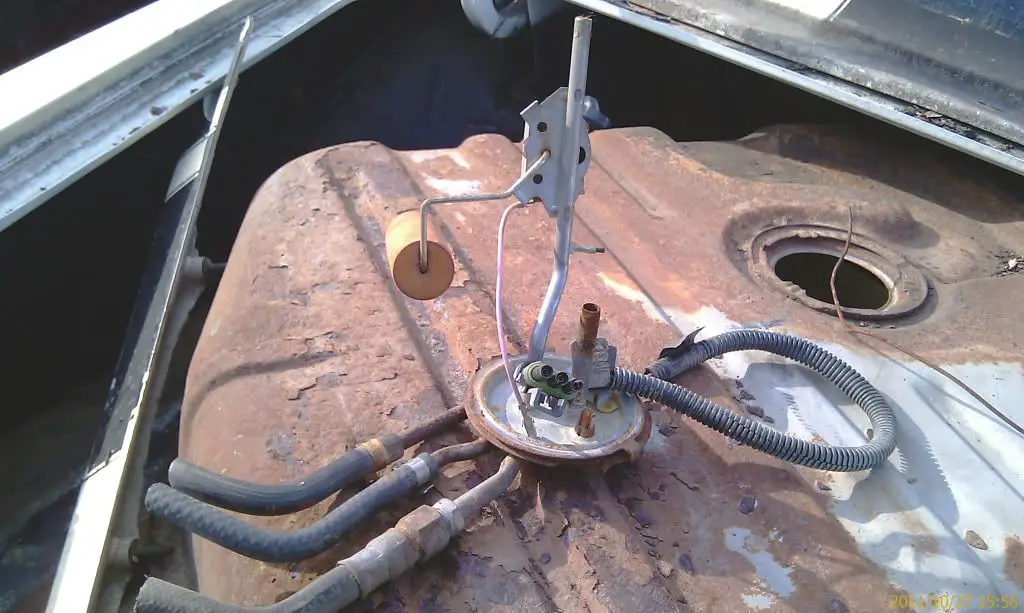

I know this is an old thread but I have a question. I found a Monte Carlo at the local yard with the tank already removed & in the trunk. It looks like someone dropped the tank to get pump out of it. The tank has some surface rust but I checked & its solid. After a little cleaning it will look good as new. Let me know if this is the tank & parts I need for my LSx swap

Yep, right sending unit too! :D
