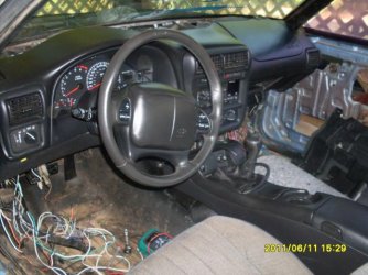

now its time for the dash :D getting everything in and plugged up now for the steering column i had to cut the camaro column because it was too small and a totally different shape than the elco .the el camino holder is on the left .. i put the holder in and bolted in place then placed the camaro steering column through the hole connected it to the steering arm in the engine bay the tighten it all down before welding it(the holder to the column) in...

now for the center console .. i cut the floor ,welded in a piece of metal that i shaped with a hammer and the ground ;) the i built two brackets to pick the console up about 3 inches closer to the dash. welded them in and bolted in the console....

its going good all of the interior pieces are in and ready still got to order carpet and custom stereo stuff. should be finished completely by next spring/ summer. i have driven it a few times and it pulls like CRAZY !!!!!
