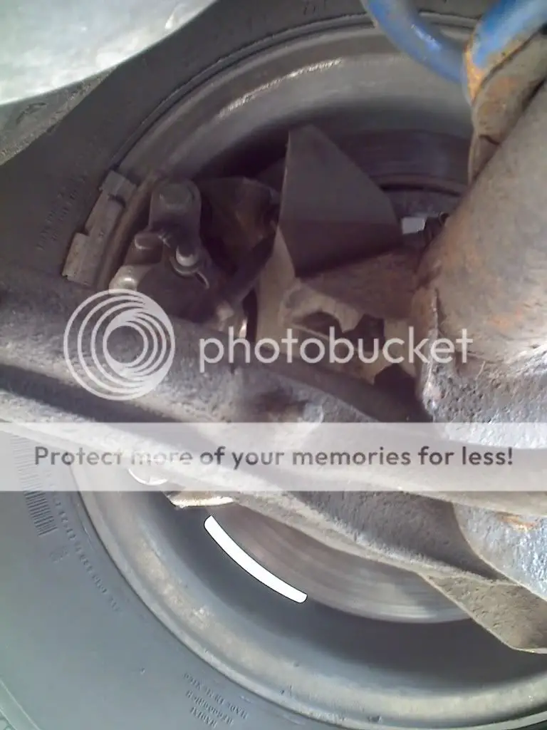

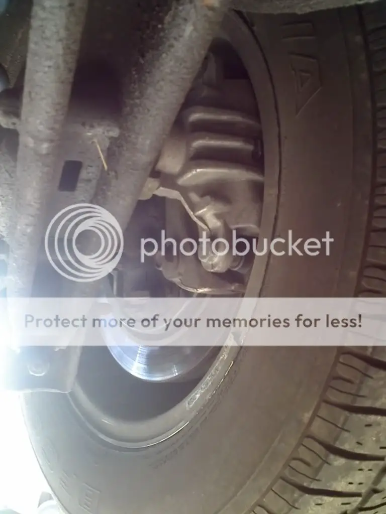

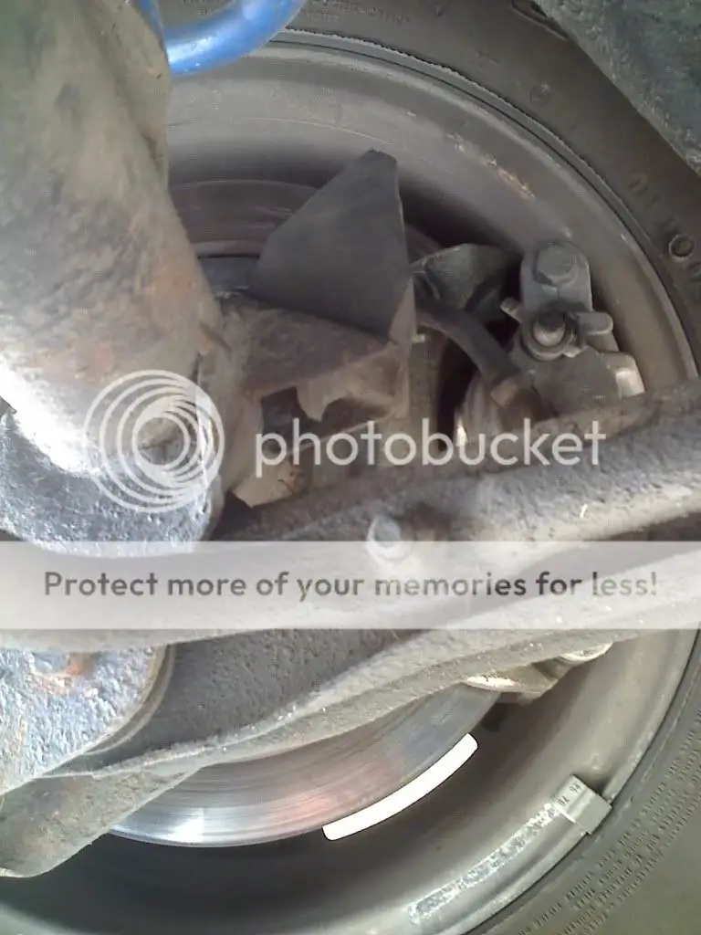

axisg said:mine are mounted facing the front of the car. Appx the 10 o'clock position from the DS with the wheel off. Sorry for the crappy cell pics. I used the rubber brake lines that came with the calipers, and cut and welded tabs to the axle housing to mount the hose to. I also ran a new hard line and bent them 90 deg at the end to screw into the caliper hose.
this one is the PS
