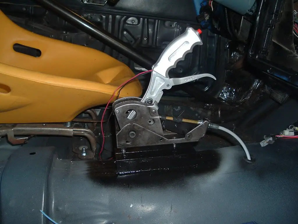

Hurst Pistol Grip....TH400 Reverse/Manual. The shifter I have will work with a forward or reverse pattern. With my reverse pattern when shifting from 1st to 2nd you have to squeeze the trigger and hold it or else you could pull it thru 2nd and all the way into 3rd. Sounds like a PITA but actually it isn't at all. I have been running it for a few months now (on the street and the track) and have never had a problem. Hurst does make one where the plates are interchangable and it is not an issue. I bought this one off of craigslist for $75 brand new minus the cable.
