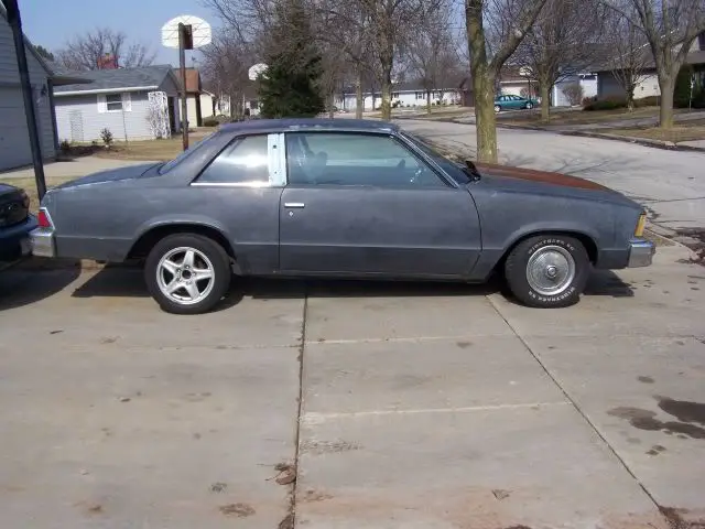

heavychevy09
Feb 23, 2009
green bay, wi
new set up
16x8's with 245/50's
2" adapters

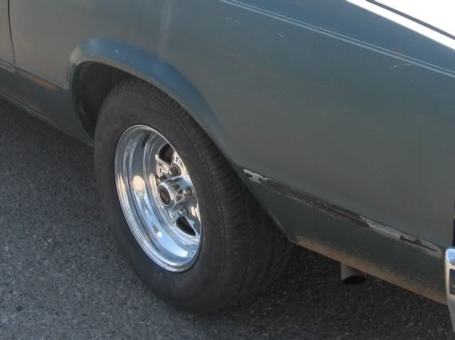

80montecarlo
Apr 24, 2008
1,123
cloverdale b.c. canada
rear: 15x8 w/ 4.5" b/s Weld draglites w/ a 1/2" spacer, with 27x10.5 MT Et streets stock frame stock wheel wells(with lots of room!!)
front: 15x5 Weld draglites, w/ 195 65 R15 radials
