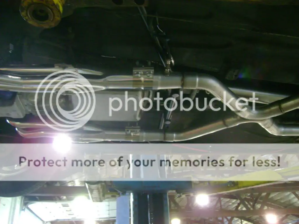

the collector on the header is pretty long, you could cut it down shorter if you needed to. you could put 2 small cats on it and build the Xpipe after that(the X should be as close to the collectors as possible but sometimes its not feasible). to save some space you could use a cat with a 3inch inlet and 2.5 inch outlet and slip it on the colletor
i had my car up on the lift tonight so i took a pic of the layout so you can see it a little better

Thanks for the pics! It gives me a much better idea on the spacing and how you did it. I like that you welded the O2 bung on the reducer so you didn't have to mess up the headers.
I've been looking for cats and I even found a couple with the O2 provision. But in checking Summit, Jegs, etc, I'm having a hard time finding a 3 in/2.5 out cat with or without the O2 bung. I really don't think there will be enough room for the reducer and the cat.
