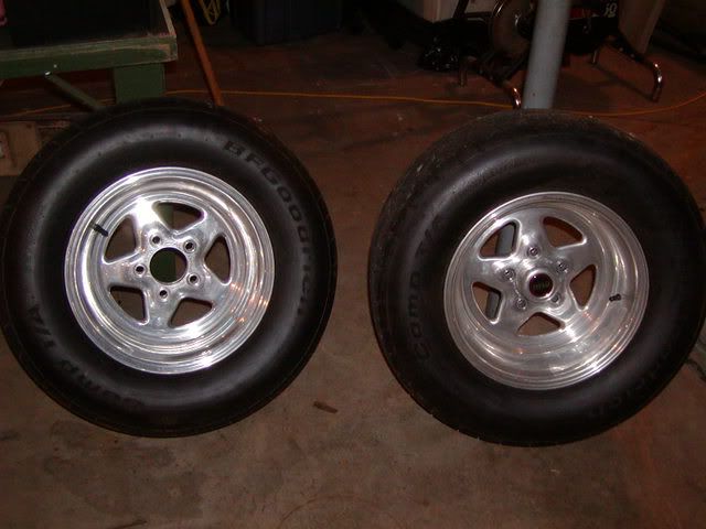

yeah stock length 8.5 with 255 mt drag radial
i think the 255's might fit , but i'm going to put a 275/60 on soon
i should have some pics tomorrow

btw , i weighed them the rear were less than 1/2 pound heavier than the pro stars
the pro stars did not have the center caps in
fronts were a little more than a pound heavier , again the pro stars did not have the center caps
KAB
Nov 30, 2005
117
jersey
mine fit without rubbing , with a 3/8 spacer
but they deffinetly tuck in more than the 3.5 back space rim
not sure how i like them yet , wish they had a 9" rim with 4.5 bs
