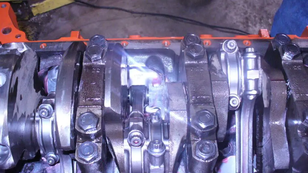

Bringing this back to life. I have the rotating assy back from the machine shop balanced and ready to go. Block will be ready tomorrow. I need to buy bearings and was wondering what brand/style you all would reconmend for my build?

I have had good luck with the Clevite ones. I have used them in all my engines. In fact the Nova 355 is is ready to be assembled with Clevite H series bearings.
Bar50
Jan 31, 2009
1,871
Tulsa, OK
X2
Clevites are perfect!
Don't need any special oil pump, just a good one. Good deep sump pan too. I have run tons of sets of small rods with good bolts. The pistons will give up before the rods do. The 049 & 781 are the best open chamber heads period.
What compression ratio did you end up with?
Switch pitch, did you buy a stall from the Buick guys, say Poston or TA Performance? I am pretty sure they never came in Chevy cased TH400's.
Drag racing, go with a Victor-O, Team G, or Strip Dominator Tall. All around RPM Air-Gap.
I'd spring for a good oil pan & pick-up.
Then some Cal-Track bars.
Malibu Monte

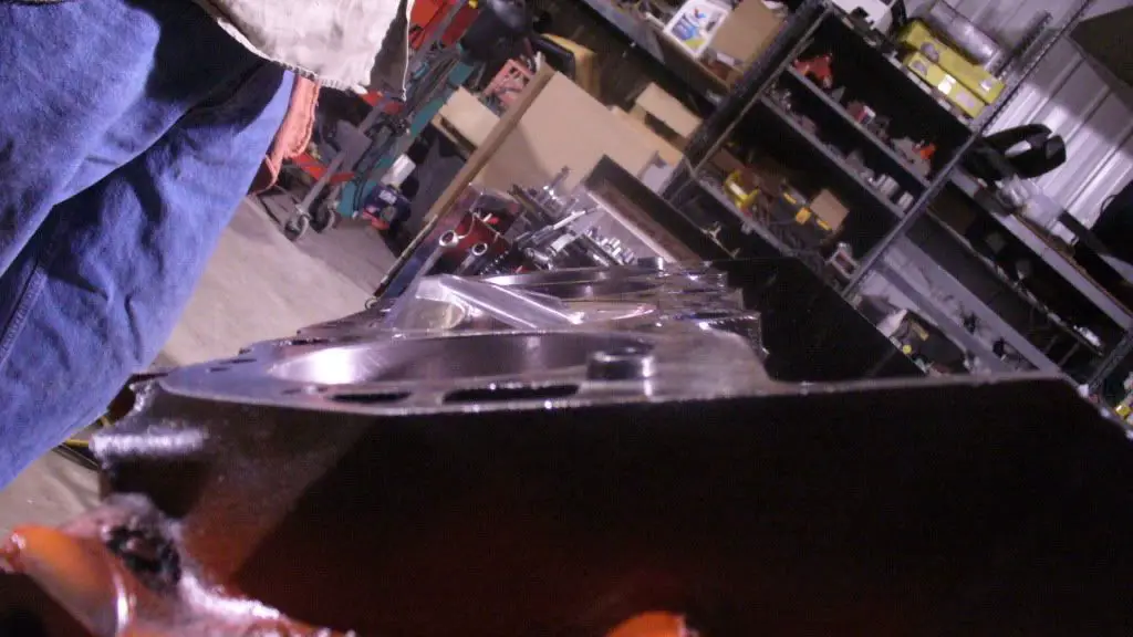

Wow Bar50 you answered many questions that I asked and some I never asked. To answer yours, shortblock is built and I used clevite bearings. Compression should be around 12.5:1. Yes the torque convertor i got is not from a Chevy 400 it is from a 300 Super Turbine that I had Buckeye Precision in Ohio rebuild. 049 oval ports are done with undercut and swirl polish 2.19/1.88 Stainless valves, guidplates for 7/16 pushrods with ARP studs and some port work. I plan on purchasing a Weiand Team G intake because it matches my cam the best, second choice is the vic jr. Also getting a miloden pan,pump,and pickup.
view of SRP domes
