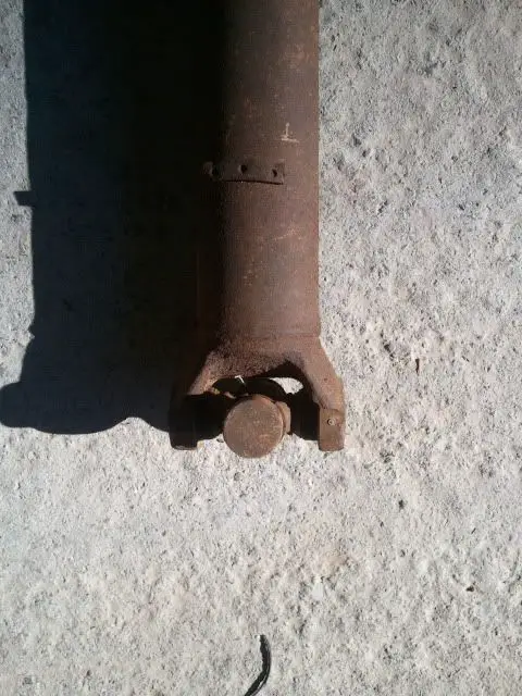

Which v6 did you have?
Mine looked like a pencil with u-joints on each end lol!
Bill in NC
Jan 1, 2004
2,725
Mocksville NC
Mine looked just like this one that came out of my sons 2.8 F-body. It's kinda hard to tell in the pic just how small the diameter is. And yes this one joined the scrap pile also.
