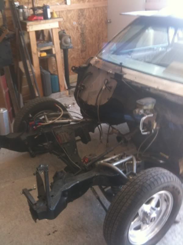

Engine out ready for new one

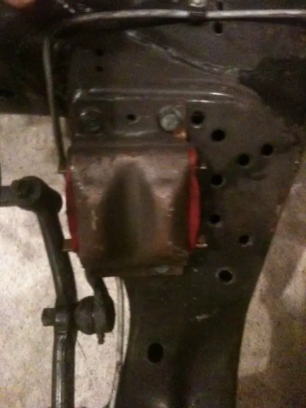

This is where the mounts were

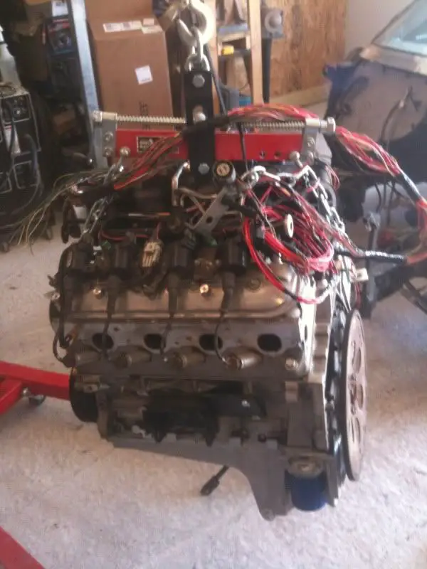

Set the new engine in

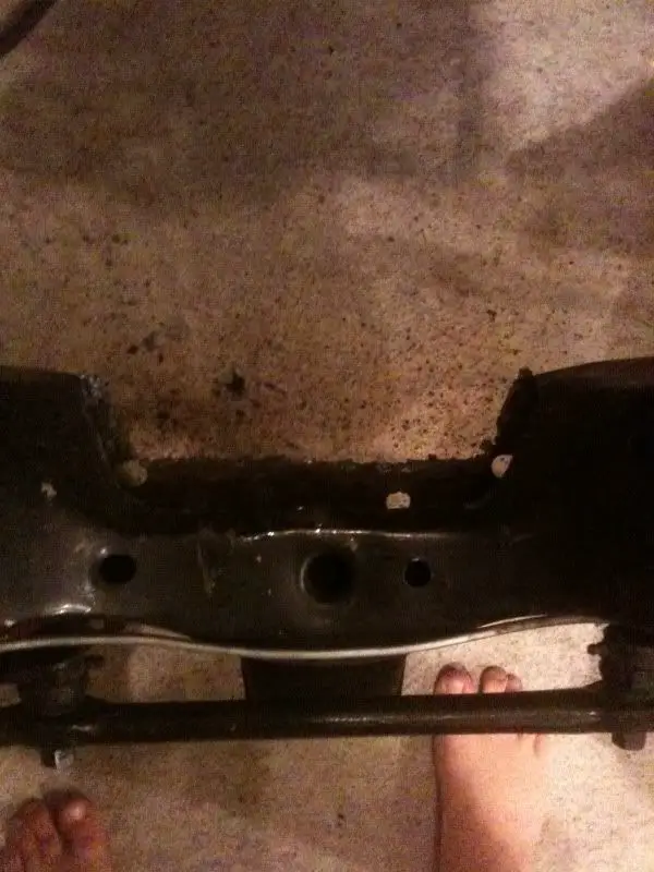

Doesn't fit hits the cross member with the new gm muscle car pan. But just barley so I try and move the mounts to a slightly further back position fight that for an hour. Doesn't work so I put the mounts back where they were and decide to "clearance" the cross member
Ignore my high value of safety equipment (bare feet) with a plaza cutter

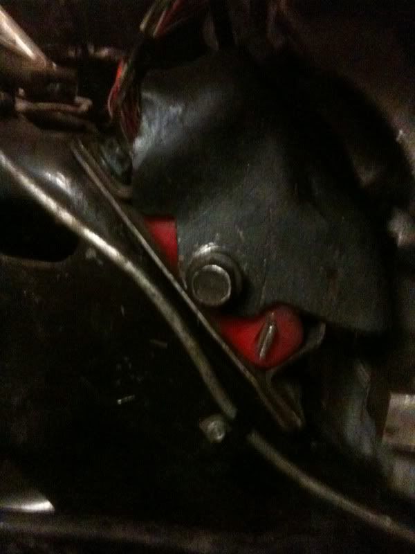

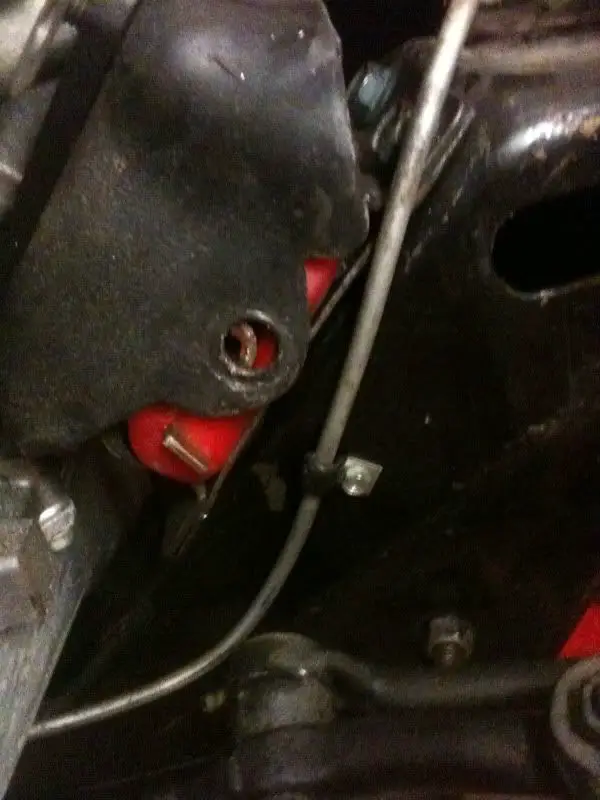

Set the engine in again for another hour fight. Now the engine goes down but the mount holes WILL NOT line up the adapters do not fit properly or I'm missing something it is midnight and I'm 4 or five whiskeys into the evening any one else seen this
Any ideas!!!

Same issue here. Ended up using the Transdapt standard adapter and installing them 1 hole back (sets engine roughly 1" back). Cleared the crossmember.
Getting the bolt holes to line up was impossible for me. Others have had success, but the 1/8" thick adapters seemed to just mess up the geometry enough since the frame mounts are angled (I am using Moroso solid mounts). I even tried loosening the frame mount bolts and had issues.
Solution- I dropped the motor in where I wanted it to be side to side. Made sure the car and engine were level and tacked the solid mounts in with my MIG. I was able to utilize a few of the frame holes, had to open up a couple a bit and it works great. Since you have a plasma I assume you have a welder 8)
I am sure others have a better solution, but this is what worked for me.
