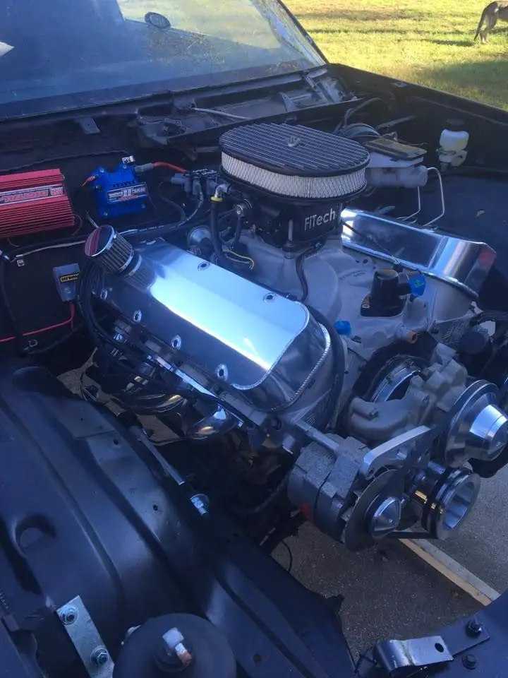

It Runs. Started on the first try, fired up instantly. New FiTech fuel injection system does not like the open headers. After a couple minutes it learned that the O2 sensor is right at the collector dump and it made a bold adjustment. The 20.4 AFR made it run pretty bad. I honestly am surprised it ran at all. The fuel delivery on the throttle body is pretty impressive too. I have the Mean Street and it tried to deliver enough fuel at idle to make 800 hp. 8 injectors running 100% duty cycle!! Pretty sure it needs the oil changed already.

Awesome! O2 sensors need pipe afterwards so that the exhaust actually travels over & thru the sensor to give a proper reading...

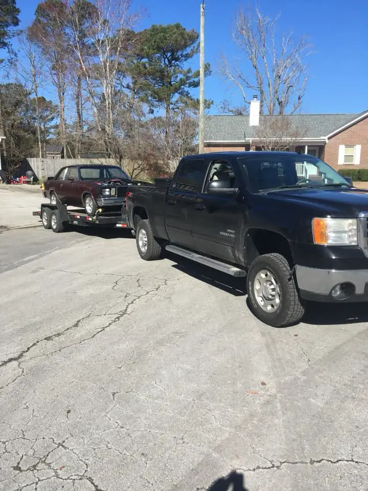

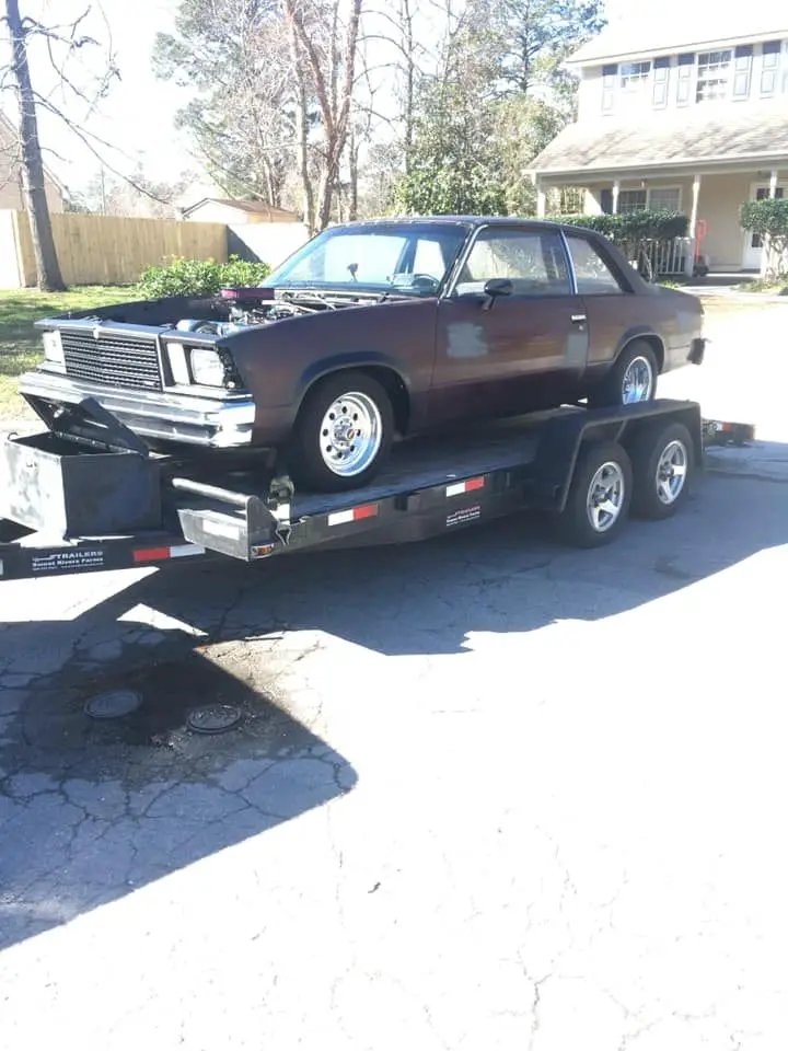

Thursday I took the car to get the exhaust done properly.
Car is on the road. Friday I drove in and out of the driveway. Worked out a few kinks.
Saturday I drove around the neighborhood. More kinks removed.
Sunday I drove across town and back. More kinks to iron out.
  • Like
Reactions: StreetBu
TURNA
Jul 6, 2003
6,028
Socialist NY
Hey driving it around town on a trailer doesn't count!!!
